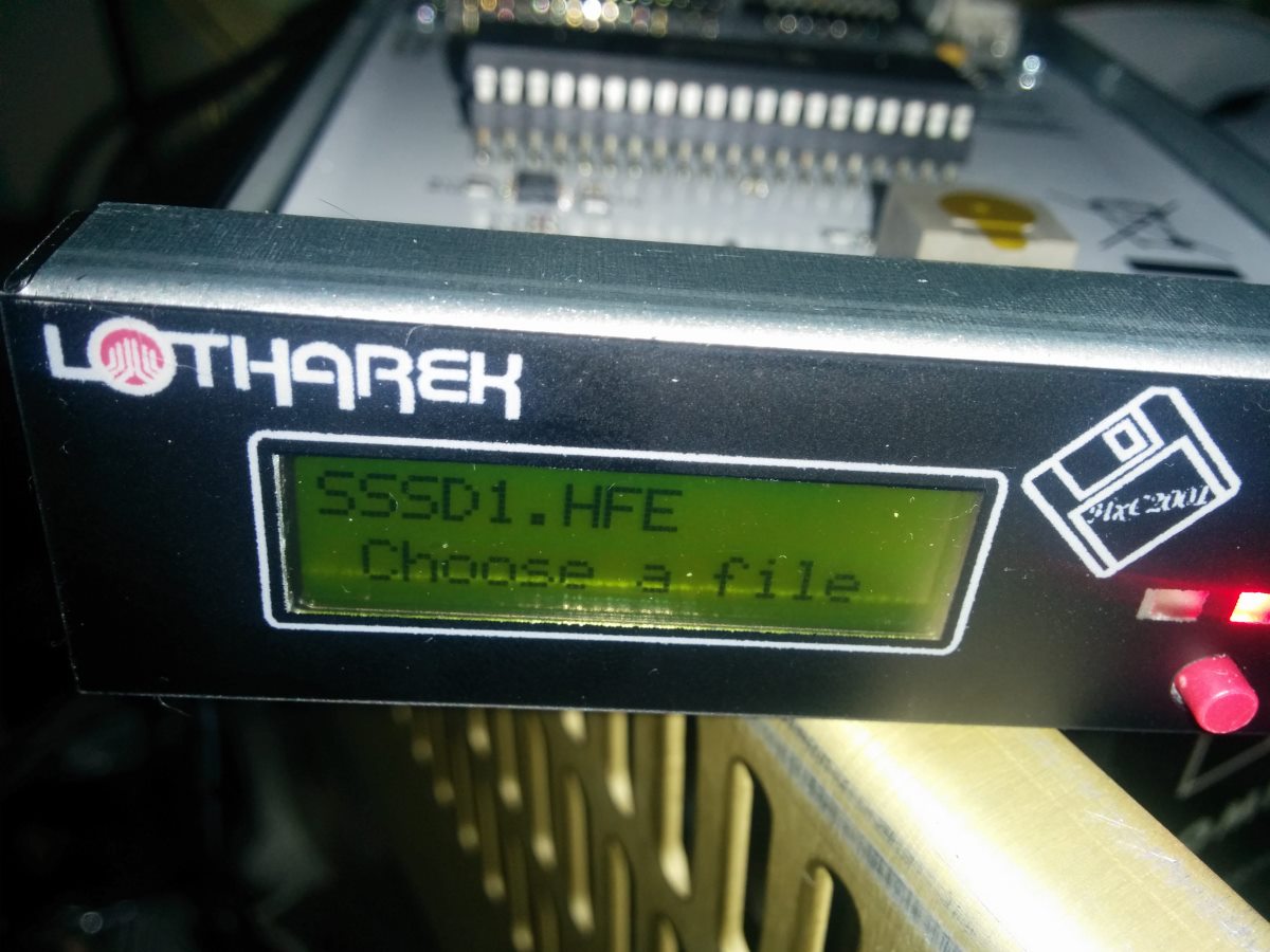

Hello - I must be missing a step somewhere and could use some assistance.
I have an Advance Digital Super Six S-100 board that runs CP/M 3 from dual 8" SSDD floppies.
The board has both 50 and 34 pin floppy connectors so it's possible to use 8" and 5.25" drives simultaneously. Every combination I've tried so far still gives a "drive not ready" error on the HxC emulator. I've currently got it setup so that drive A(0) is the 8" floppy drive and B( ID1) is the HxC emulator. The HxC is connected to the 34 pin cable, which according to the circuit diagram should not be a problem. I've created a couple of test HFE files, one formatted as an FM 8" SSSD standard IBM3740-type floppy, and the other with the same settings but as MFM. No matter what I select as the active floppy, I still get a "drive not ready" error in CP/M when trying to run the Format utility. I'm no doubt missing something really simple here, but I just can't see what it is.

- 2016-03-05 20.50.15.jpg (138.95 KiB) Viewed 27441 times

Re: Problem with 8" CP/M System
have selected the image on the emulator ? (this is not the case on the picture)
Yes, it is selected when I have tested, showing 77 tracks in the second line status display.

"I still get a "drive not ready" error in CP/M"?
Connect pin 34 of HxC to pin 33 (ground) to have the HxC hardware look "ready".
Use HxC utility CREATE DISK to format an .hfe image.
When the HxC display says "Chose File" touch the middle button to actually choose the file displayed. When it is chosen, the bottomline will show the track/sector last accessed by the system.
The HxC2001 can do MFM double-density which is normal for IBM DOS, but cannot do M2FM double density which was normal for a lot of 8" CP/M and Intel MDS disks.
All the 8" CP/M and Intel MDS disks are 360RPM. The disk created as the .hfe image and selected will control the repetition rate of the INDEX pulses the HxC hardware issues that tell the target's FDC it's connected to an FDD spinning at 360RPM. If the FDC sees 300RPM, it will object (show not ready).
