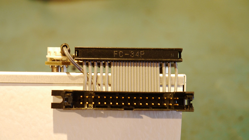

Here's the hardware Mod...
Best
John

Re: HP 1650A Logic Analyser
Hardware issue probably. Are sure that the drive is rotating at 600RPM ? Can you check this point ?
Also try to set the switches ID0-A+ID1-A+ID2-A+ID3-A to ON.
