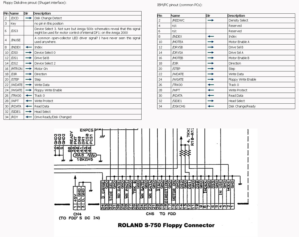

Sorry to harp on this, but I was having a bunch of trouble getting working HFE's for the emulator and figured it would be wise to make sure they were working Roland images in the first place, so I've gone back to this.
I've tried a ton of stuff and am currently on one of the Teac FD-235HF's which has been tested in a Windows PC beforehand. It's a 7240, which is one of the ones without jumpers, but I've switched it to DS0 with a PCB resistor, and the adapter I'm using gives decent access to the pins.
Right now, it looks barely alive on the Roland. It sounds like the motor spins up, but it takes a while and I don't hear or see any signs of seeking. The LED stays off, I've tried the 2-34 pin swap, but the service manual pinout looks as though they're in the normal IBM configuration. I've also tried the pull-ups on 2 & 34, but nothing seems to change.
From looking at the attached pinout, does anyone here have any ideas on routing mods,etc. which would make a regular PC floppy work in this thing?
Much Thanks!

The pull up resistors on pin 2 & 34 are for sure needed.
