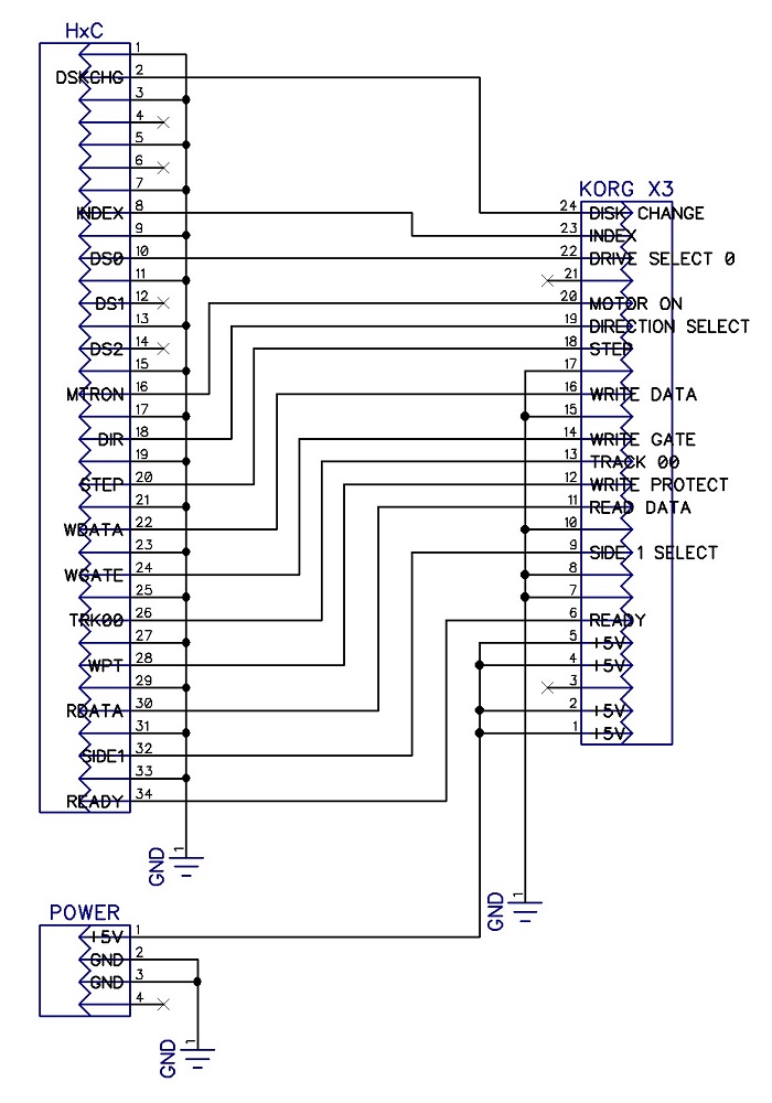

Ok, i went ahead and bought a Rev F.
Made a schematic for the adapter. Does it look OK?
- 24 to 34 pin adapter
- adapter schem.jpg (137.54 KiB) Viewed 120827 times
Re: HxC for KORG X3?
Yes it does.jh95 wrote:Ok, i went ahead and bought a Rev F.

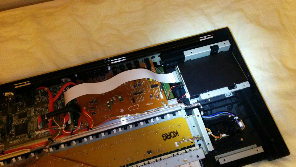

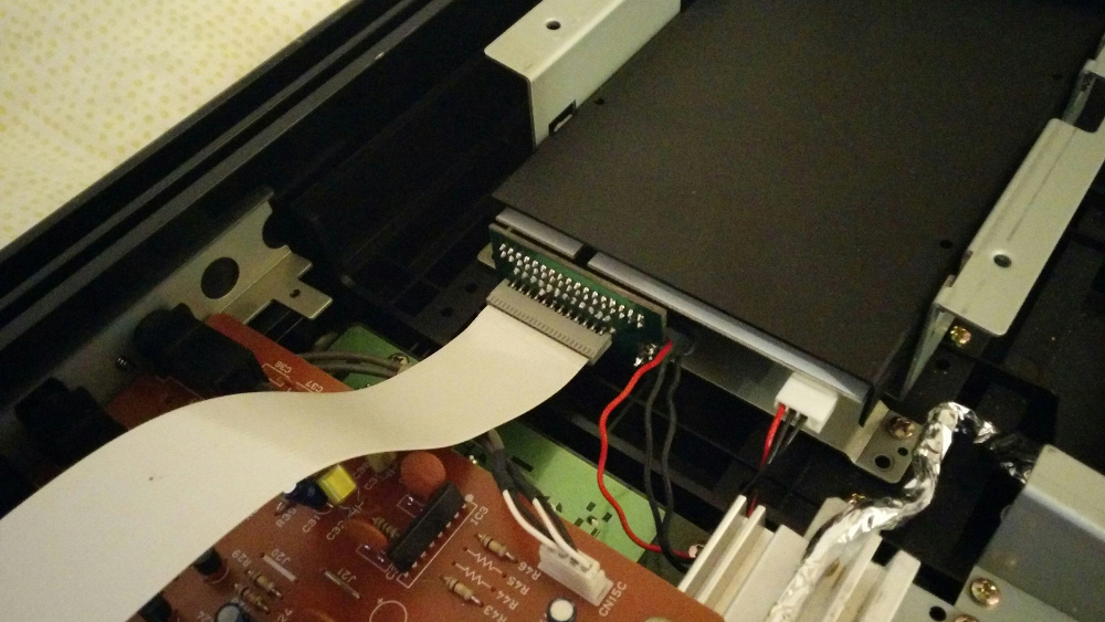

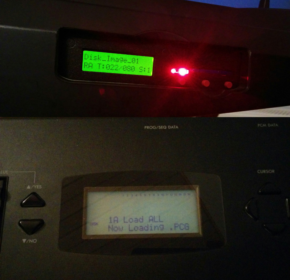

Here are some pics.
- Doing a test load with factory presets disk.
- loadtest.jpg (224.82 KiB) Viewed 120531 times
- It's a DIY adapter with a 2-sided board and solder mask. I'm waiting for a batch of better boards from OSHpark.
- adapter.jpg (215.85 KiB) Viewed 120531 times
- internals.jpg (223.91 KiB) Viewed 120531 times
Thanks !jh95 wrote:Here are some pics.
And btw this is nice and clean adapter !
