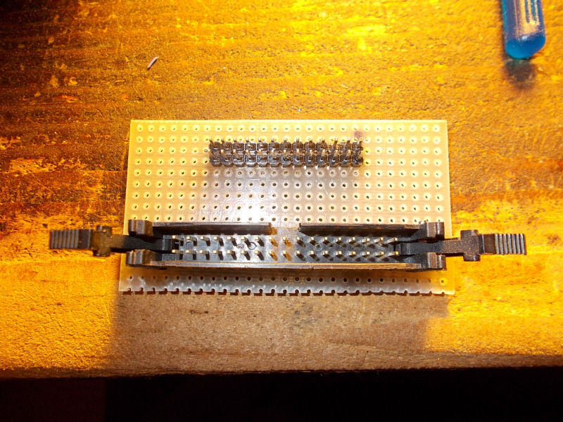

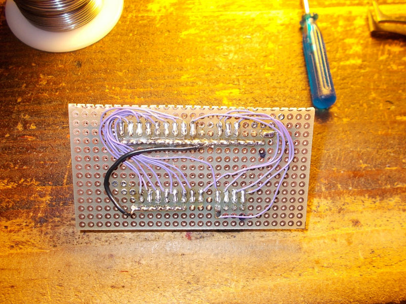

Hi, today I successfully installed an SD HxC Floppy Emulator on a NEC PC-9821As2 which originally use two FD1138T FDDs.I built a simple adapter from 26PIN of the FD1138T (using original FDD cable, header on motherboard has 30 pins) to 34PIN of the HxC, I took power from the HDD connector using a molex to berg cable (but if you want, you can take it also from PC-9821 FDD cable since +5v is present on pin 1-3-5).Pinout of FD1138T can be found on this document, I think this is valid also for other 26PIN FDDs that come without VFO like FD1138C (not 100% sure though, since there are variants of same model):
http://www.geocities.jp/cpuparts98/FDD/ ... 26CONV.pdf
Here are some pictures and a link of a video.
https://www.youtube.com/watch?v=UhcG2ini8dM
