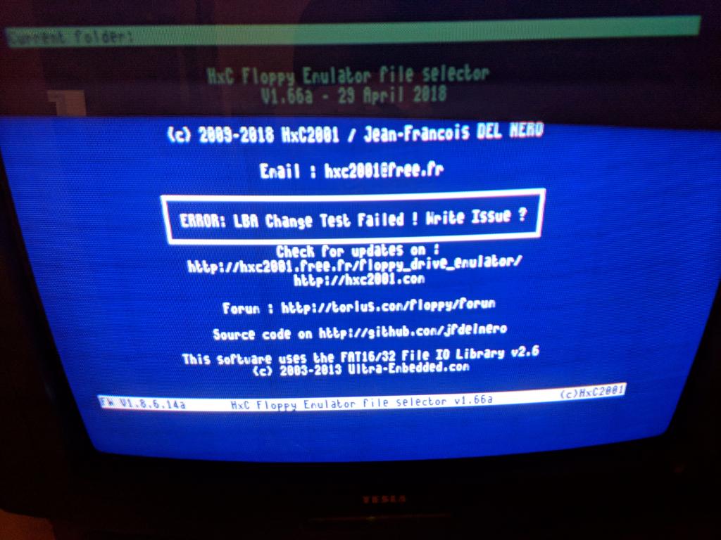

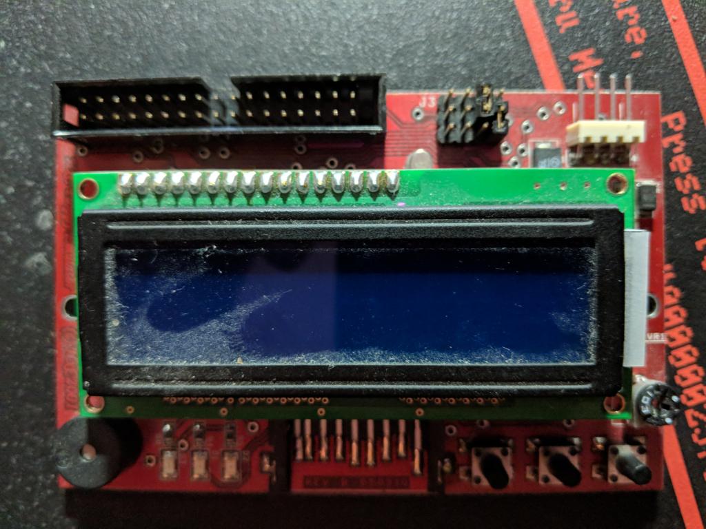

OK, this took a while to get back to. :) This is how my HxC emulator looks like:
After flashing latest beta + latest manager I get:
And indeed, even when using plain HFE images, writing seems to be broken (sort of ignored). Is it possible it has been caused by the latest firmware?
Apart from that, I see one issue which may define all the others: during the power up phase I see "SRAM failed" error. What could have caused it?
Re: SDCard Manager is 2.01 is not working
mikro wrote: Wed May 23, 2018 11:07 pm
Jeff wrote: Fri Feb 26, 2016 8:34 am
mikro wrote: I'd say "default". Didn't change a thing since I'd gotten my HxC years ago. Where do I find them?
on the emulator.
You have the Rev A Hardware. 2 solutions :
- Downgrade to the v1.7.2.0
Or
- Add the missing SRAM IC.
mikro wrote: Thu May 24, 2018 12:05 am Are you sure it isn't Rev.C hardware?
oh yeah sure ! You have a collector version :D.
mikro wrote: Thu May 24, 2018 12:05 am Where can I download such old firmware?
https://hxc2001.com/download/floppy_driv ... d_RevB.zip
mikro wrote: Thu May 24, 2018 12:05 am Is there any 'upgrade guide' for adding the SRAM IC?
In the release note. see "22/08/2010: Firmware SD HxCFloppyEmulator v1.3.0.0"
Post by mikro »
Awesome, the old firmware indeed did the trick. Not only "SRAM failed" error is gone but also the manager and writing work again. And it took me only three years to figure out. ;-)
