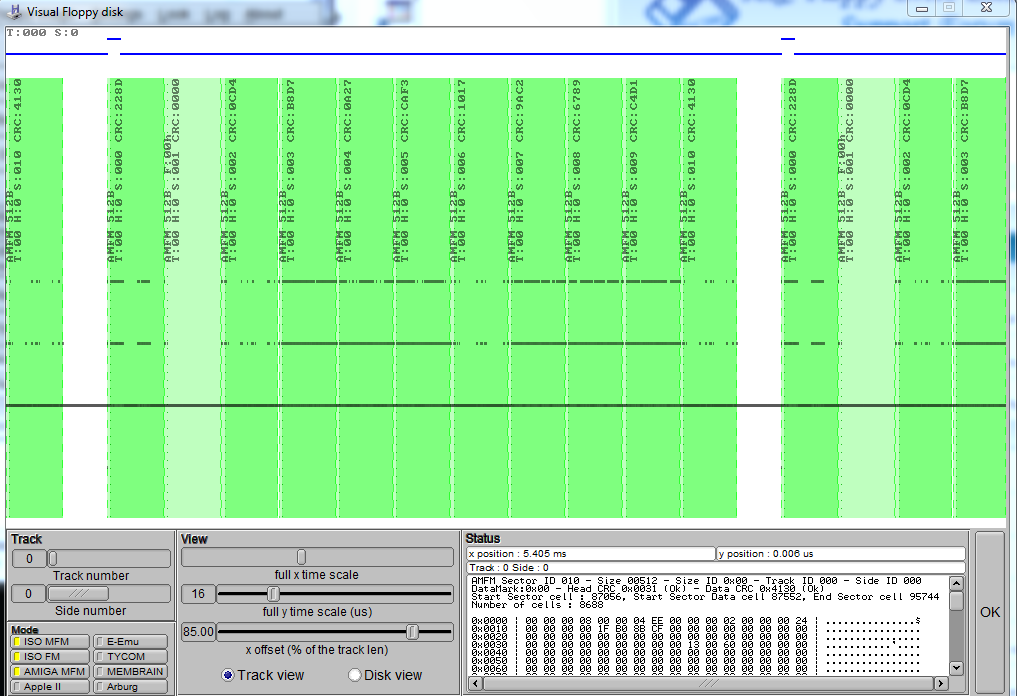

Use the hxc software and the track viewer to check your disk image.
Re: Debugging disk read/write issue
Ok, I did that, not sure exactly what I'm looking for. All of the sectors of each track are bright green (i'm assuming t == track s == sector), but track 0 has a few sections that are sea green.
I've attached an image
- Capture.PNG (105.91 KiB) Viewed 5700 times
