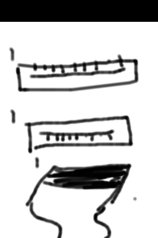

I cannot connect the drive because the conductors are on the bottom of the socket on the old drive.
On your drive, the conductors are on the top. I would have to flip the cable upside down to plug it into your drive, and this would reverse the pins.
I tried to flip over the plastic locking clip on your plug, but it
just won't lock down the strip in that position, and I don't want to break it.
