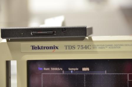

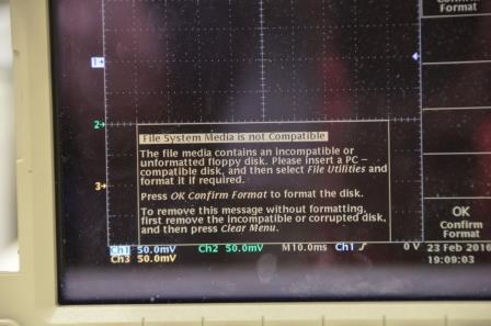

Re: Slim SD HxC Emulator for Tektronix TDS oscilloscope

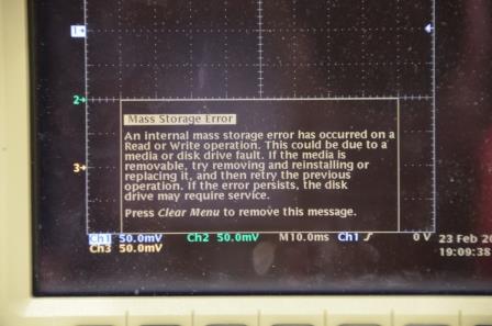

we are new in this forum, so sorry for our questions. As dfrie we have some problems...
Sadly our recently purchased Slim SD HxC Emulator is not willing to cooperate.
It is intended to replace the original TEAC FD-04HF 2301-U in our TDS 754C.
Problem is that I can neither read nor write.
We added a 1Kohms resistor at the R8 place on the emulator, as Jeff told us in the forum some years ago. No way.
After trying some configurations (HXCSDFE.CFG) we removed it - no way.
DIP-Switches of the emulator are set to 1010 0000 or 0010 0000 or 1000 0000. If the DIP-Switches are like the PC-compatible-mode (0110 0000), the emulator isn't recognized by the oszilloscope.
We have tried the 1.44MB files from the quick install, and others as well (like told us in the forum). No way.
With indexed I mostly get error message "file system media missing" from the scope,
with non-indexed mode I get "media not compatible".
So we received some error massages - see the pictures.
Thank you for your help, HSA_TUM

- TDS 754C
- 01_TDS_754C.JPG (55.74 KiB) Viewed 21132 times
- Error Massage File System
- 02_File_System.JPG (64.6 KiB) Viewed 21132 times
- Error Massage Mass Storage
- 03_Mass_Storage.JPG (64.41 KiB) Viewed 21132 times
Thank you Jeff!
For those who have similar problems - information: we get some firmware-update, .cfg files form jeff, the swich 1111000 without a 1 kohms resistor!
Now it works!
Heartfelt thanks!
HSA_TUM
