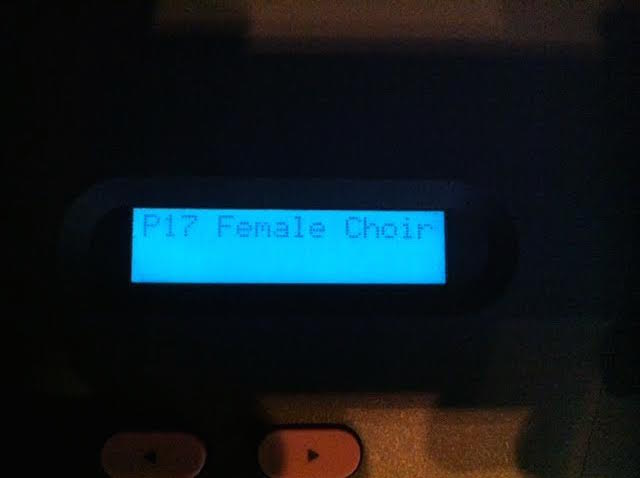

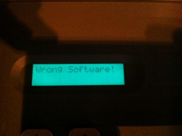

it seems to boot fine and loads, even shows the bank for 1 second then flashes the "wrong software" error message

- unnamed-2.jpg (18.82 KiB) Viewed 19083 times

wrong software

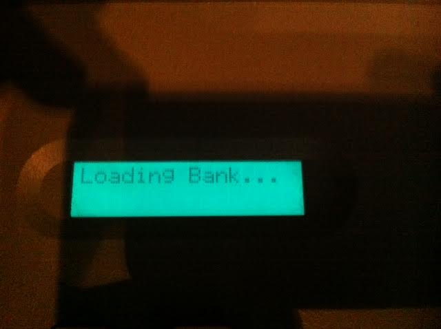

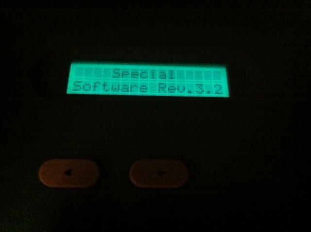

Re: problems setting up my HxC drive

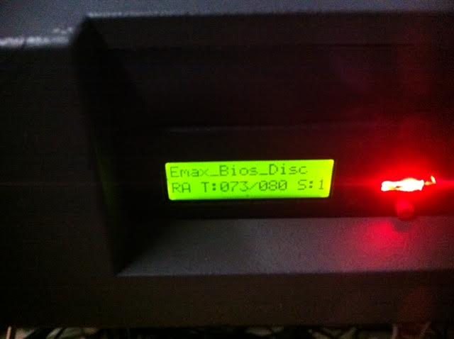

ok so after reformatting the SD I was able to boot the Emax Bios Disc file as seen in the pic
it loaded the OS and also the bank of sounds which all played fine and all functions worked
I was able to verify that the Emax was running OS 3.2

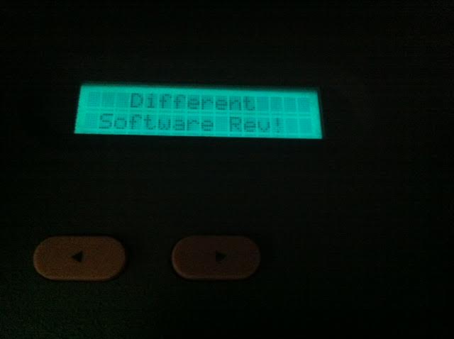

unfortunately i was only able to boot the Bios file and could not access any other banks on the SD
then it came up with the "Different Software Rev" error
seems that i am in need of a proper Emaxos.emx file that is compatible with my machine

different Software Rev error message
- unnamed-3.jpg (11.41 KiB) Viewed 19064 times
hi Jeff
this is quite confusing but i spoke with someone on the yahoo group and he told me that my older emax 1000 unit can boot OS 3.2 even if it is non SE and non SCSI
this i have confirmed this because when i copy the quickdisc floppy install image files to my HxC disc, it boots the Emax Bios Disc and loads the OS 3.2 as well as the program sounds inside and they work fine
i think whats wrong is i need a version of the emaxos.emx file that is the same version as these quick disc image files which is 3.2
this way I can load the OS as it is and when i batch convert my EM1 banks with this emaxos file i need they should load ok

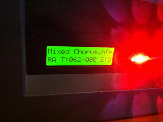

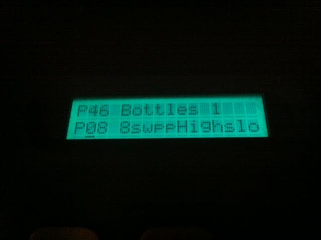

so after getting a hold of an emaxos.emx 3.2 file I copied the quick disc floppy image install files to the SD then batch converted some of my EM1 banks with this emaxos file and they now load.
the only problem is that once they load, i can select another bank but it will not load. i i turn the emax off and on it even remembers the last bank i selected and then loads it no problem
any idea what the problem could be?
im thinking it might be setting in my CFG file
