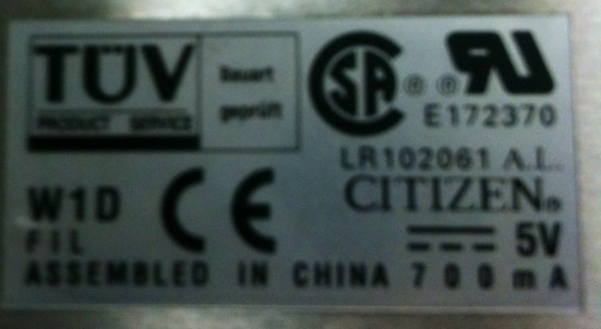

Compaq Armada 7800, drive:314941-001 1.44mb.
Have old drive - plastic case with drive inside.
Opened case- Citizen L102061 A.L.
Ribbon strip (old brown type) drive itself has a slot to slide
in plastic strip (not pins)

Looks like 26 pins on the single-sided 27mm strip.
The custom plug is on the other end.
So a strip slot (F) to 1.44 adapter (F)

The Slim HxC should do the trick, but a picture is better to judge.

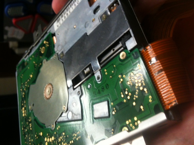

the ribbon look likes to be quite large... are you sure that the contacts pitch is 1 mm ?
Re: Need a trickier one now
My photo is VERY parabolic close up. Sorry. See my pinkie?
This is also a very THIN drive. Note how thick in my palm.
My little wooden ruler eyed very carefully said the
Plastic strip is 26.5mm snuggly.
(About 1 & 1/16")
I checked again just now as I posted.
Ah! Yeah. I see what you mean.
Probably 1mm pitch in Mfg speak.
Using my lighted microscope...
The teeth on the socket... line up on the
1mm marks of my ruler very closely, so
Yup!
