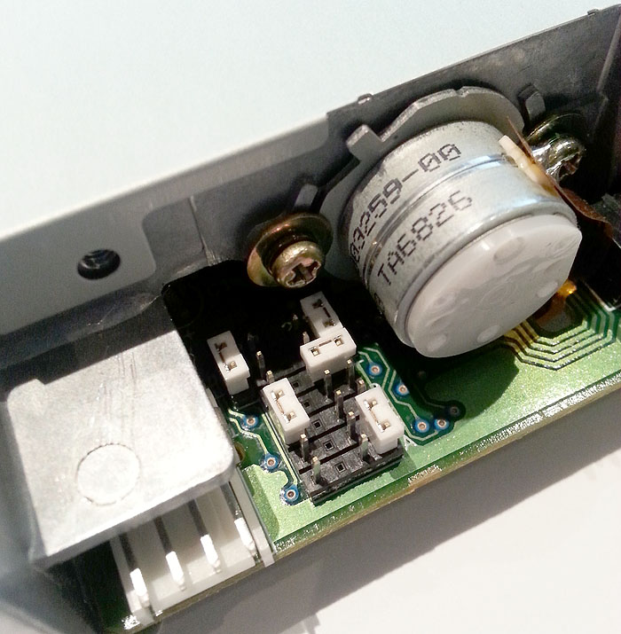

Post by FCross »
Attached is a picture of the jumper settings for the drive.
Re: HxC Used to replace a TEAC FD-235HF using a FC-1
what is the exact model number of this drive ?
