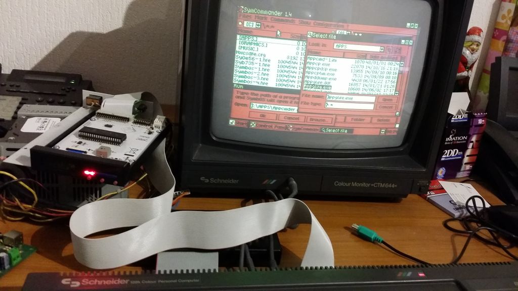

I got it working on the Amstrad CPC in SymbOS:
Now you can access the whole content of the SD card inside the HxC, as it is added as another mass storage device.
Some bug fixing and optimization has to be done now...
