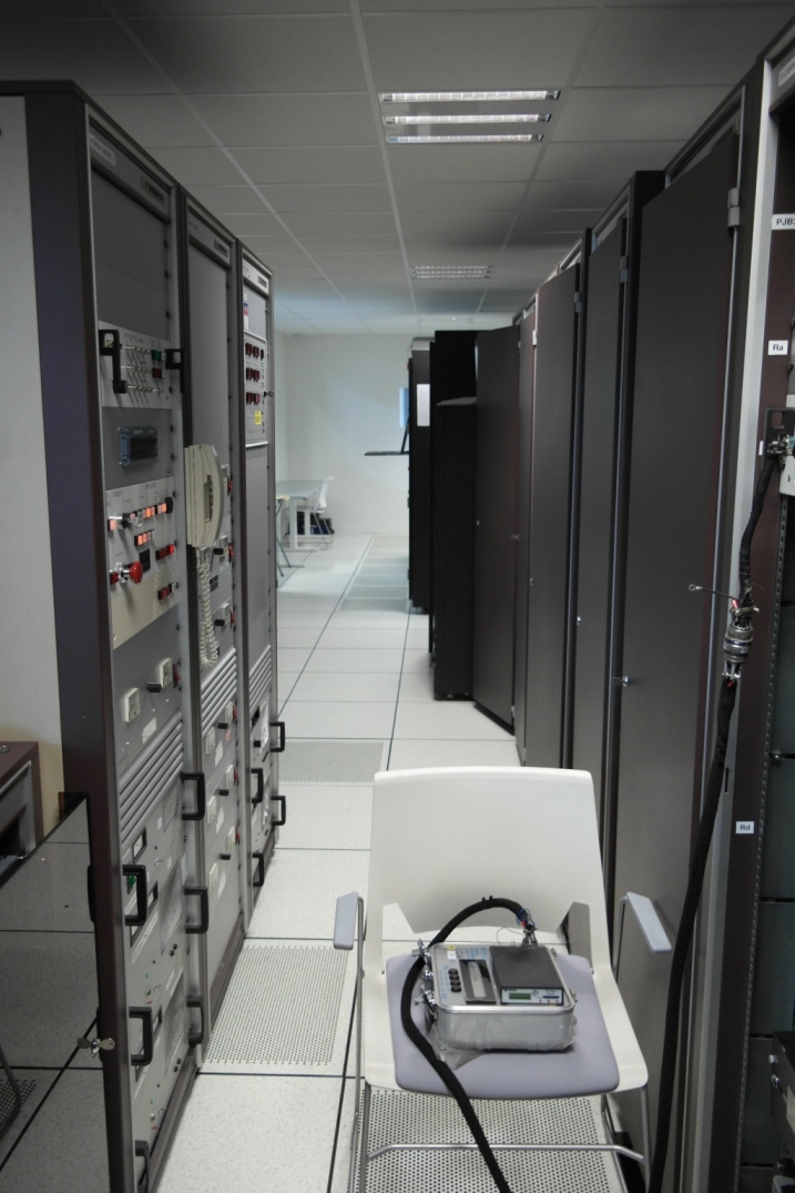

On site installation and customisation of a HxC Floppy Emulator into a Teledyne FMC Data Loader for Airplane (used here into Flight Simulators). This type of data loader is used with various FMC Airplanes (Airbus, Fokker, Embraer...).

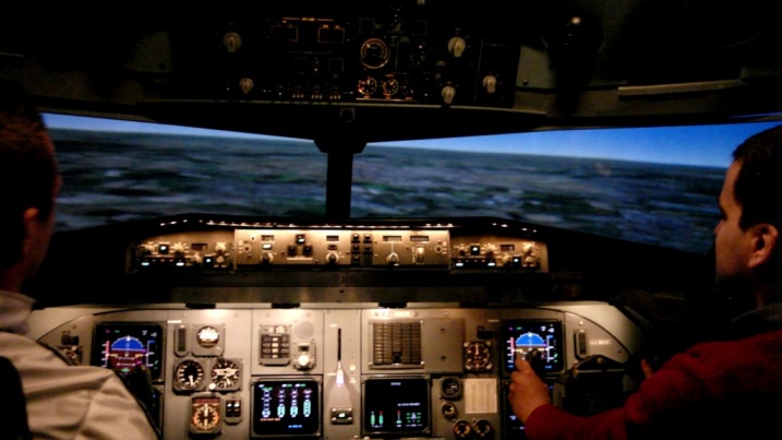

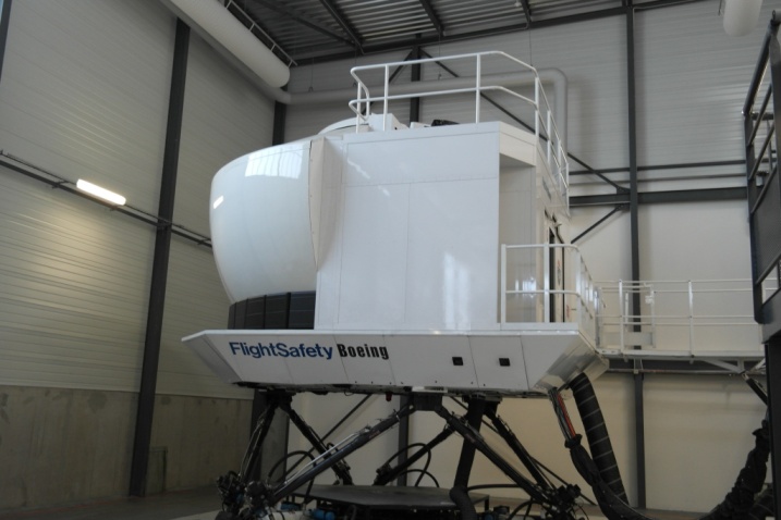

Fokker F100 Flight simulator in operation.

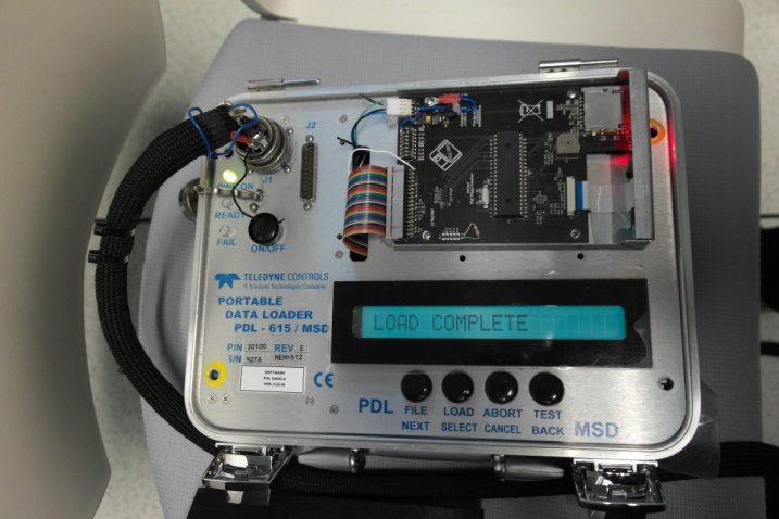

SD_HxC_Floppy_Emulator_RevF_Teledyne_Controls_Data_Loader_PDL_615_Airplane_FMC_Data_Loader_001_medium.jpg (83.88 KiB) Viewed 7798 times

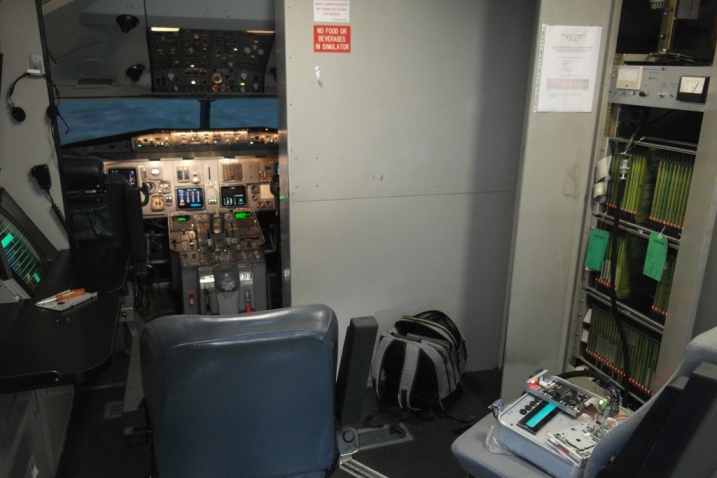

The Teledyne PDL 615 Data Loader equiped with an HxC Floppy Emulator.

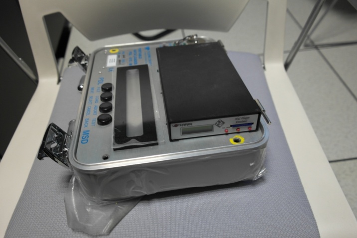

SD_HxC_Floppy_Emulator_RevF_Teledyne_Controls_Data_Loader_PDL_615_Airplane_FMC_Data_Loader_004_medium.jpg (104.2 KiB) Viewed 7798 times

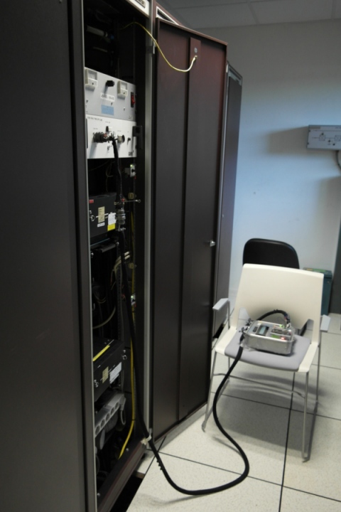

Fokker F100 Training Flight simulator FMC connected to the Teledyne PDL 615 Data Loader. This one is equiped with an HxC Floppy Emulator.

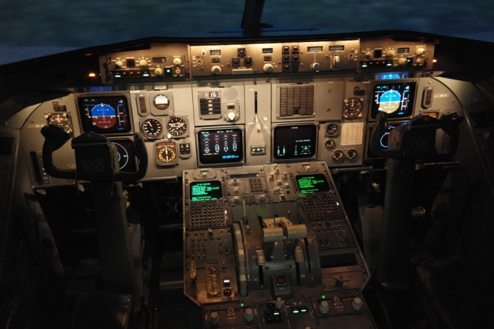

Fokker F100 Flight simulator cockpit.

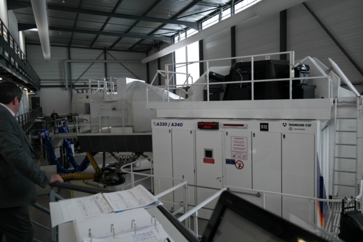

Airbus A330 / A340 Training Flight simulator.

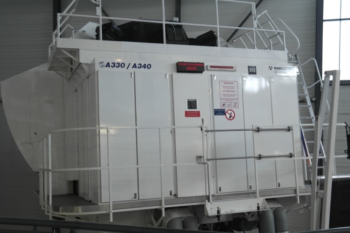

Dear Jeff
Could you give some detail about converting floppy driver of Teledyne PDL to SD emulator ( or USB ) .
Just removing floppy driver and insttalling emulator is enough or do we need some action ( software loading ..etc..

Re: A330,A340,Fokker F100 Airplanes FMC Data Loader retrofit
hatukoy wrote:Dear Jeff
Any info?
From what i remember, there is some modifications to do :
thermal sensor to move on the hxc, ready additional signal, drive selection connected to the vss, additionnal pull up on the data signal...
