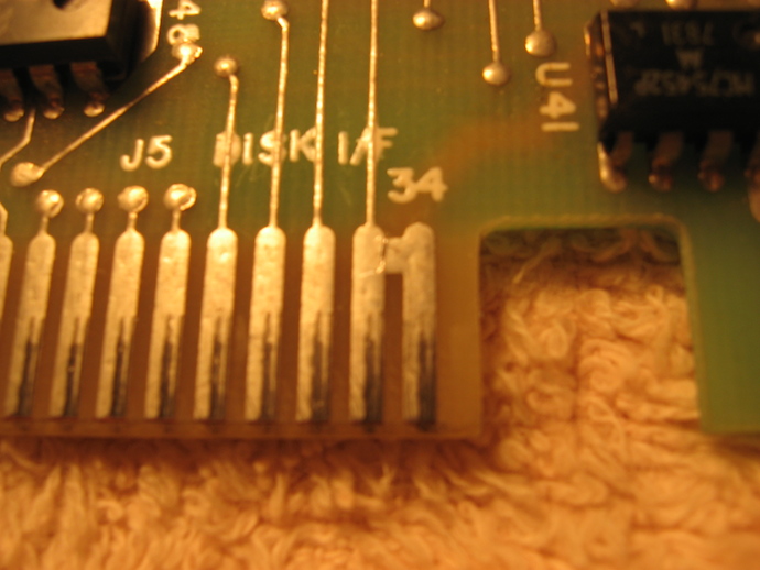

I just opened the Expansion interface for the TRS-80 Model 1 and Found that they had joined pin 32 and 34 together.
So your Floppy READY signal was coming back on pin 34 and forcing the pin 32 LOW Grrrrrr.
I have got an AXE :: }} and removed the shorting link and will now test it without adjusting terminations.
This is only for the Early version Expansion Interface Board ONLY.
The Later (Redesigned) Expansion Interface the pins are NOT connected together.
https://www.dropbox.com/s/suhnseso7t7yd1f/Pin32-34.JPG
I will inform you of the progress.
Yours Ray
Yours Ray

Hi Jeff
Trs-80 Model 1and the HXC
The problem is resolved , remove the bridge between pins 32 and 34 and it works PERFECTLY.
If you have helpful notes for specific Computers that connect to the HxC please include this fix.
Thanks for all your support and patience. I OWE you a Beer or Meal if you are ever DownUnder.
Yours Ray
Yours Ray

Quite strange this short. So the ready signal isn't used by this machine ?
In this case you have just to set the pin 34 to HIGH into the embedded HxC menu. No need to cut the track.
