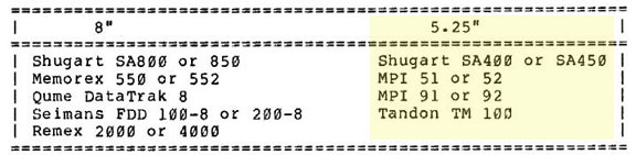

I am restoring a 1980's S-100 computer system equipped with a California Computer Systems (CCS) 2422 Floppy Controller. The controller has a connector for 5.25" drives (34 pin) and 8" drives (50 pin). There are 2 8" Shugart 800/801 drives equipped, but aging media is making these unreliable so I am looking at other options. I should also mention that I have a mix of Hard Sector and Soft Sector disks as the Shugart drives are switch selectable for either.
I am interested in the SD HxC Floppy Emulator and I am trying to confirm if it is compatible with the 2422 Controller and Hard/Soft Sector files. Drives that the 2422 is compatible with are:
Drive Compatibility
Drive Compatibility
2422 Drives 1.jpg (56.8 KiB) Viewed 10180 times

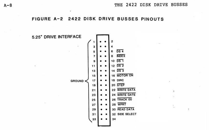

Since I intend to use the 5.25" drive connector, these are the drives I need to simulate. I believe the drive rotation is 360 RPM and the connector signals are as follows:
Controller 5.25" Drive Connector
Please let me know if the current version of the SD HxC is configurable for this purpose.
