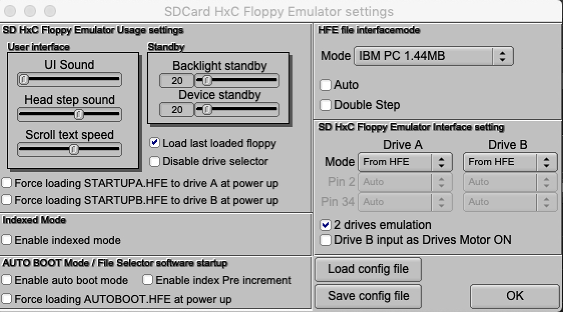

    I opened the Emulator software and configured the HXCSDFE.CFG file as seen in the screenshot.
What am I doing wrong?

Oh well. I've got everything up to formatting a disk running. After the formatting the sampler gives the message »missing address mark« and boom, back to square one. Does ANYONE have any idea what this means? There is no mention of this in the ESI4000 manual as an error message.... :? :(
Re: E-MU ESI 4000
caonai wrote: Mon Jul 22, 2019 9:04 pm hm... seems pretty dead around here.
Have you copied some 1.44MB PCHD HFE files to the sdcard ?
