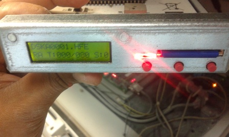

I have problem with Hxc on my machine. IT would be offset printing machine.

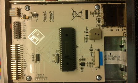

I'd tried to install this hardware replacing from an old Floppy disk.
HxC
HxC
Only I got serious problem. The led indicator (right side) always lid, either there is any SD card inserted or not.
led
led
I can select and choose FDD image (*.hfe), only the led still lit.
Please kindly support to get the problem gone.

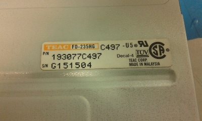

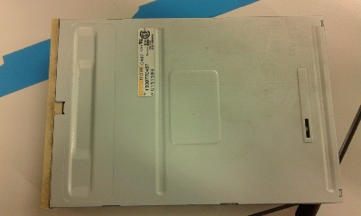

and please give me more elements :
-> Old disk drive brand and model ?
-> Machine brand and model ?
-> Does this machine use "dos"/fat12/"readable by a computer" floppies ?
please post some Pictures of the machine and the old floppy disk drive.

My machine is an offsetpress printer "Komori Lithrone 40", using an TEAC FD 235hg c497.
Yes, they use FAT12. When I tried to saved any machine configuration to FDD, I can read them on my PC. They would be saved as txt file.

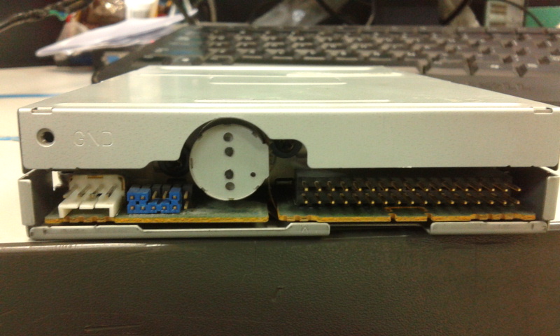

I need to see the jumpers of the drive !

Here is the pict of FDD jumper,
Hopefully it can help.

Reconnect the floppy cable as you did in the first time , and try to change the interface mode :
-> remove the sd,
-> press the button "select"
-> Interface cfg
-> shugart.
-> exit

I have tried to select 'shugart' and anything left read from HFE, it doesn't worked. Both led still lit.
What about Dip switch configuration (ID0A-ID3A,ID0B-ID3B) ?

Did you see S:0 or S:1 at the second line ?

Yes, I see S:0 only on bottom right side of the display.
Does it means something ?
