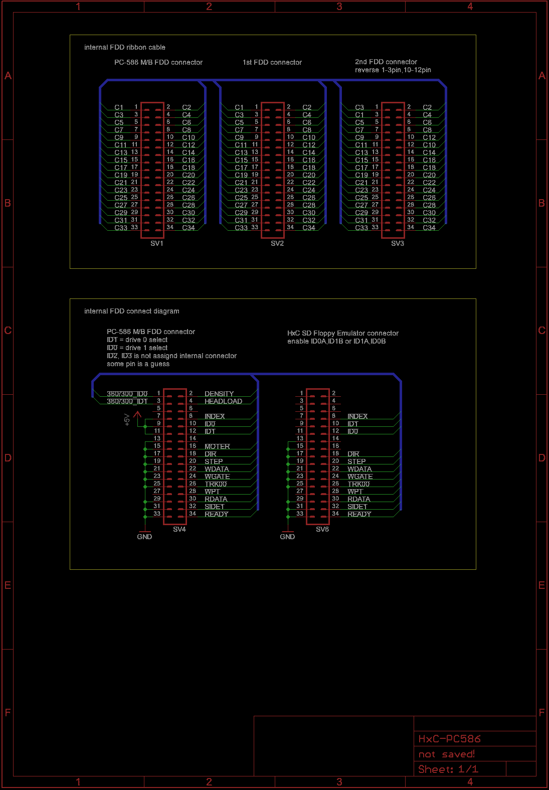

I am using HxC SD Emulator rev F with EPSON PC-586RV.
PC-586 is PC-9801 compatible computer, internal FDD is 2 drives (drive 0, 1) and external FDD is 2 drives(drive 2, 3).
PC-586's original internal FDD is EPSON SMD-340 or MITSUMI D353T3.
External FDD is PC-9801 compatible interface, available to PC-9801 general external FDD.
I connected HxC to the drives 0 and 1, and nothing connected drives 2 and 3.(see attached connecting diagram)
The ghost drives 2 and 3 is generated when setup of HxC is ID0A and ID1B(drive 0 = HxC drive A, drive 1 = HxC drive B).
But drive 0 and 1 operation is no problem.
Ghost drive is assigned a drive letter in MS-DOS, but can not be used in practice.
Of course, no problem in the case where original FDD is used to connect to drives 0 and 1.
The ghost drives 2 and 3 not generated when setup of HxC is ID1A and ID0B(drive 0 = HxC drive B, drive 1 = HxC drive A).
Do you know why ghost drives is generated?
I want to erase the ghost drives using settings ID0A and ID1B the HxC.

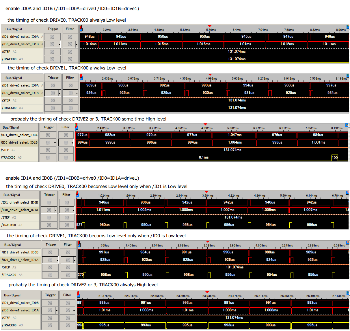

I tried to capture the detect sequence of the FDD.
Detection sequence of this machine seems to be of the following two procedures.
1)move TRACK00
It is output the many STEP pulse to each FDD. Each FDD is moved to TRACK00.
2)Detect drive
It is monitor the status of TRACK00 at the time of the Low level of /ID?.
STEP is not output at this time.
Order to be detected is ID0->/ID1->(probably /ID2->/ID3).
Attach an image captured when I set ID0A-ID1B or ID0B-ID1A to HxC.
I think that there is a problem with the output of TRACK00.
And, DIP-SW to set the ID is poor contact from the beginning of my HxC.
ID0B, ID1B is particularly bad. Is there a way to solve?
1)move TRACK00
2)Detect drive
