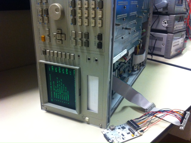

The Sony MP-F52W-30 uses a 34 pin combined power and data connector. I wired it up to my SDHxCFESlim as follows;
I will definitely post pics and video when it's working. I promise!
-Skot
Thanks for the quick reply!
Unfortunately the new image isn't working either. The test equipment reports that "The disk is not initialized".
It looks like you changed the bitRate bytes in the HFE file to 500, which makes sense. Maybe there is some other problem here?
--SDHxCFESlim-- --HP4145B (MP-F52W-30)--
NC Change Reset (1)
FLOPPY_DSKCHG (2) Disc Change (2)
NC (4) In Use (4)
NC (6) Drive Select 3 (6)
FLOPPY_INDEX (8) Index (8)
DS0 (10) Drive Select 0 (10)
DS1 (12) Drive Select 1 (12)
DS2 (14) Drive Select 2 (14)
MTRON (16) Motor On (16)
FLOPPY_DIR (18) Direction (18)
FLOPPY_STEP (20) Step (20)
FLOPPY_WDATA (22) Write Data (22)
FLOPPY_WGATE (24) Write Gate (24)
FLOPPY_TRK00 (26) Track 00 (26)
FLOPPY_WPT (28) Write Protect (28)
FLOPPY_DATA (30) Read Data (30)
FLOPPY_SIDE (32) Head Select (32)
FLOPPY_READY (34) Ready (34)
+5V (Power connector) +5V (3)
GND (Power connector) GND (15)
GND (1) GND (17)
-Skot

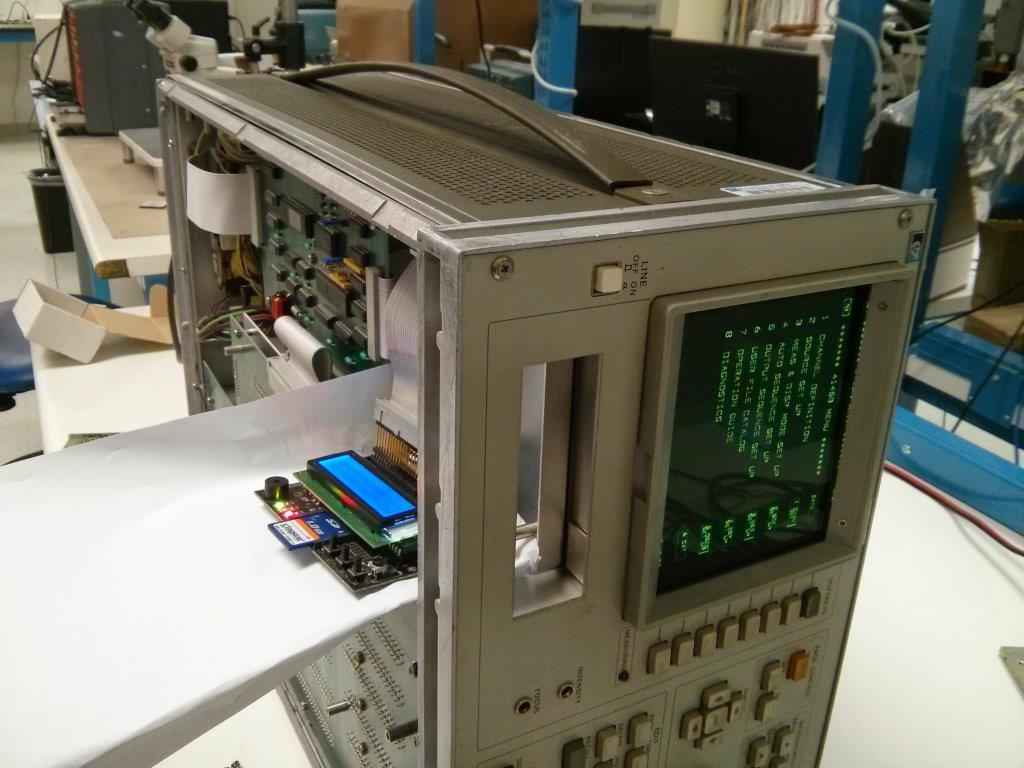

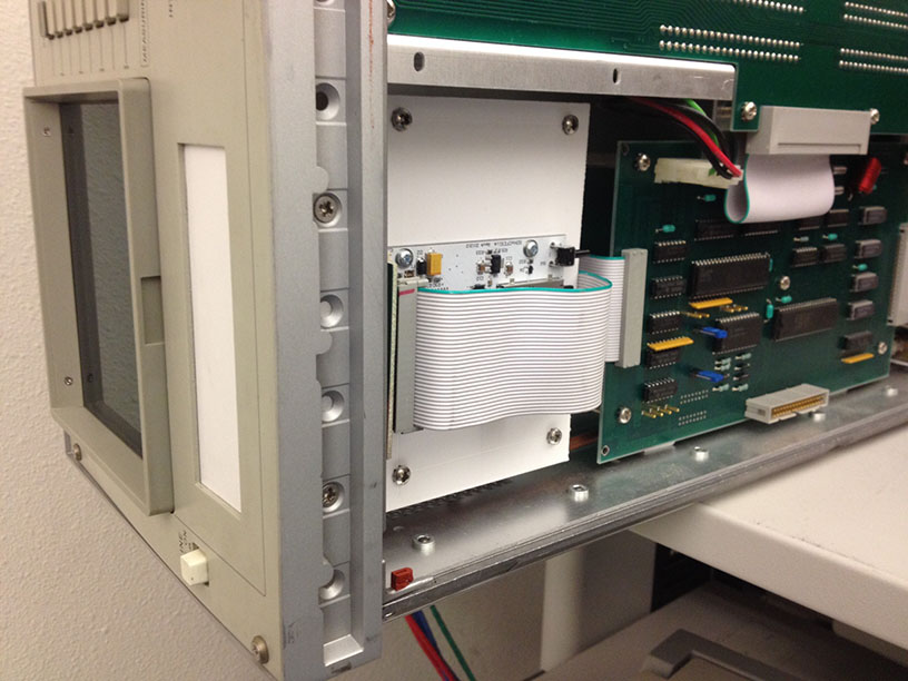

Pics with my HP4145B to HxC Floppy Emulator adapter. The emulator is sealed inside the case since we have no need to swap disks.
- photo 1.JPG (123.67 KiB) Viewed 99355 times
- photo 2.JPG (115.71 KiB) Viewed 99355 times

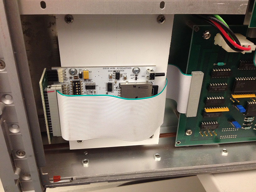

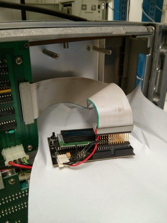

Our proof of concept hack.
Now just to dress it up.

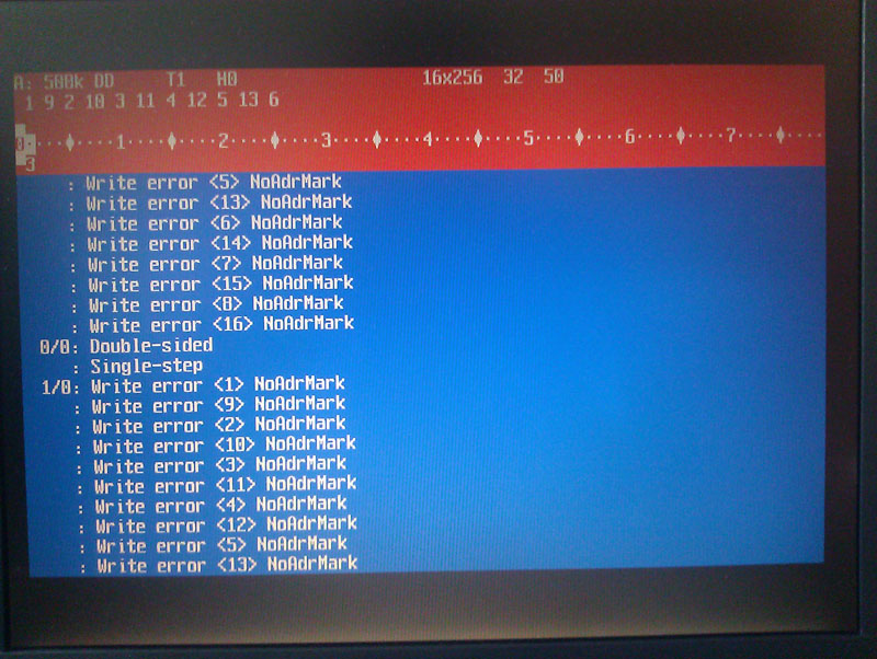

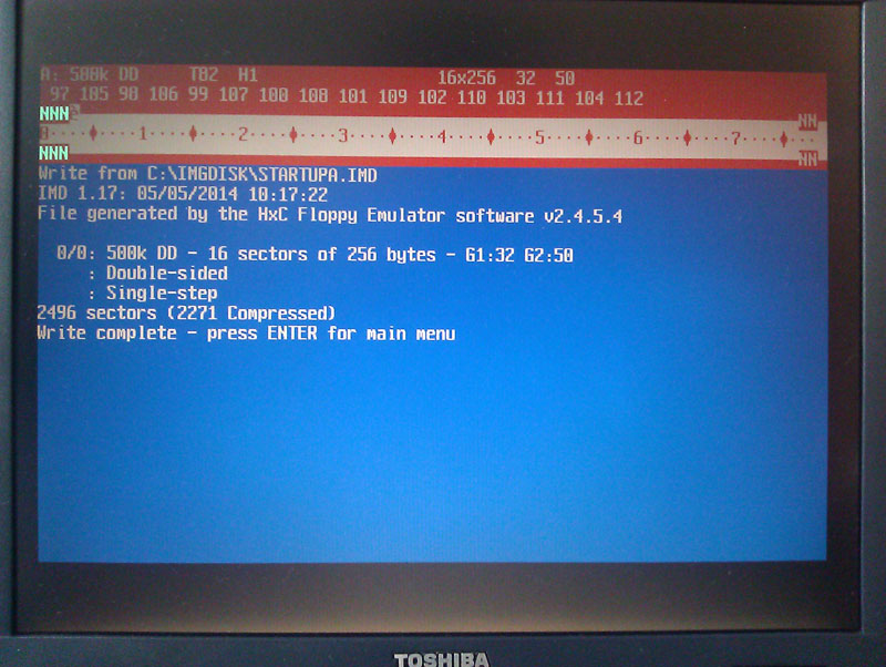

I converted the HFE image to IMD, and ran ImageDisk on a pure DOS machine. When trying to write the IMD image to a real floppy, I chose cylinders = 83, sides = two and double step = off, leaving the other options at default. When trying to write to a DD media, I get lots of errors, as seen in picture 1.
I also tried a HD disk, and this time most of the writing process goes ok, but some N characters appear at the last tracks, as seen in picture 2.
Please, do you have any idea on what can be wrong here? I read in ImageDisk docs that a 3.5" 500kbps file is HD, but the HP disk is DD! I can't understand this. Additionally, I noticed the IMD file is *very* small, 65KB only! Is not it too small, compared to a the HFE file, which is 2MB??
Well, any additional help will be greatly appreciated, thanks a lot!
Eduardo
I followed your suggestion, and it really looks promising, but I think I'm still missing something here.
Eduardo
Re: HP 4145B Semiconductor Parameter Analyzer
Retry with the attached imd file on DD a disk.

Thanks a lot, Jeff! The writing worked, but only tomorrow I will have access to the HP4145B again, so I still don't know if it will boot correctly.
The only detail are the N characters at the last tracks, it happened again. Do you think it's a problem?
