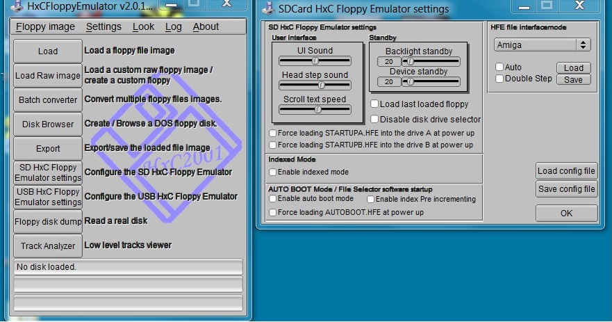

I am using HxCFloppyEmulator software v2.0.16.0, Apart from setting the drive type to Amiga DS/DD I haven't altered any other setting here.

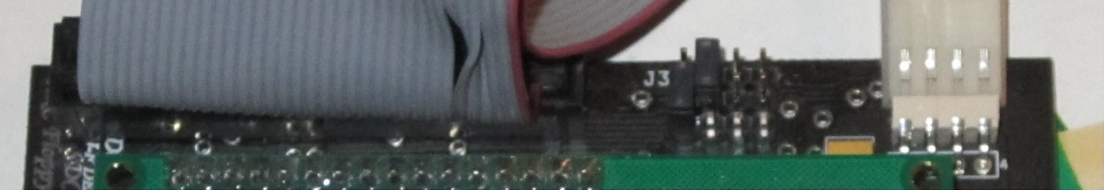

a picture of your jumper/switch setting & setup please...

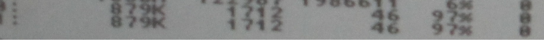

O.K Ive gotten through some initial problems but here is the problem I am now having, when I have a disk inserted on the first drive is shows as being on both drives.
On the first drive the disk acts perfectly fine but if you try and:
Access the second drive using a CLI and a simple DIR command,
Change the drive image for the first drive using the LCD and menu buttons
It screws up and complains about read errors.
This image shows the details from an info command which shows both drives containing the same volume, name excluded because picture cropped to much :)
I have configured the unit for two drives but for the life of me can not figure out how to set what volume is in the second drive.

I am uploading my config file and photos of jumper settings to make life easier, also the manual says configure things this way for a cable with a twist and that way for a cable without a twist but I can't find any reference to if you have a twist and have the drive connected before or after the twist, i am assuming after.

With the software used to generate the images when I configure the drive as being an Amiga DS/DD drive it always reverts to generic Shugart I am not sure if its meant to do this or not, but when I set something I expect it to stay that way, if Amiga is generic Shugart can the software reflect this by saying Amiga-Generic Shugart - it's very annoying otherwise and confusing.

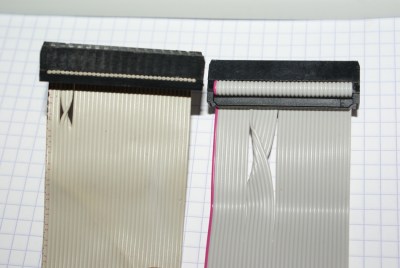

Jumpers in bad position : Your floppy cable is NOT twisted !!!
Look at this image :
The floppy cable in the right is twisted. The left one don't have the twist
on the DSx lines...

Thanx for the reply I have adjusted the jumper setting and now it's working fine, My bad for not checking which lines were twisted but I just read in the manual if you have a floppy cable with a twist do this - which I did :) but I didn't check what the twist was changing.
