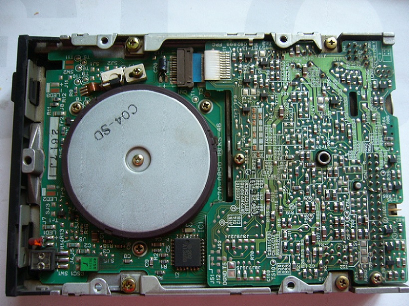

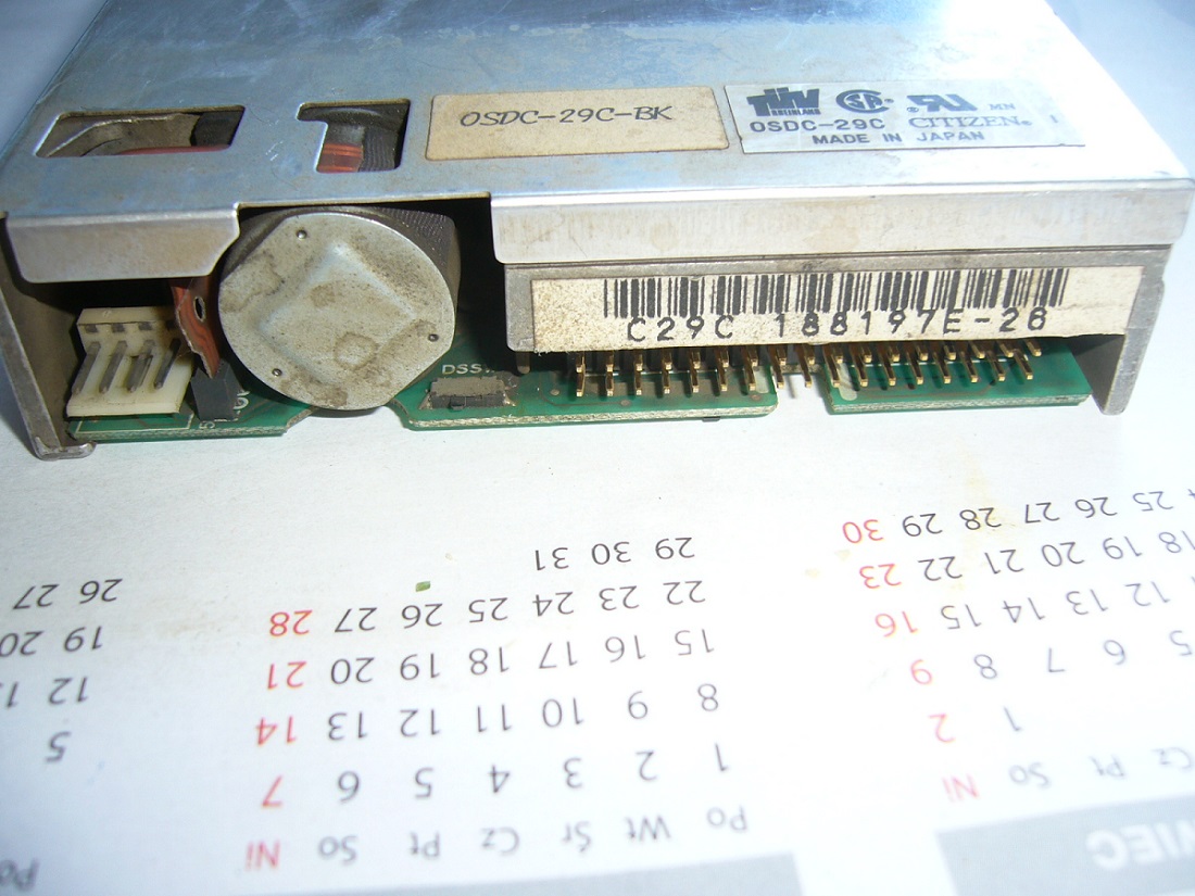

also : please give me the exact model of the floppy disk drive used into this machine and the jumper setting of this disk drive (a picture please).
Re: Delem 720kb problem
Firmware already updated, nothing changed.
- P1020803.jpg (238.58 KiB) Viewed 58030 times
- P1020802.jpg (249.48 KiB) Viewed 58030 times

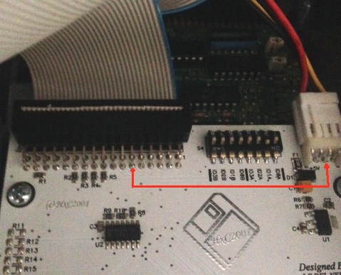

First you need to update the firmware :
To get the latest firmware (in the "Beta_Firmware" folder) :
Update procedure video (second video) :
https://hxc2001.com/showroom/HxC_Floppy_ ... Demos.html
The files to copy to the SD Card with the new CFG file to use :
https://hxc2001.com/download/floppy_dri ... SD_HXC.zip
Regarding the drive switches, the ID3-B(8) switch must be set and the ID1-A (2) switch must be set.
You also need to connect the pin 12 of the floppy connector to the ground. See attached picture :
Best Regards,
Jean-François DEL NERO
HELLLO, Jeff
thanks.
It works perfect.
Better than new!!!
