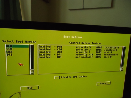

The board is detected as DF0: on the CDTV and DF1: on the Amiga 1200 when connected using the external port.

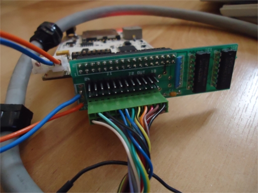

- Drive options, DF0: internal and DF1: (slim) external.
- 3.jpg (108.8 KiB) Viewed 10625 times

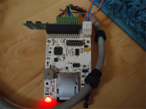

- External floppy connector
- 2.jpg (133.3 KiB) Viewed 10625 times
- Slim connected to the external port of the Amiga1200.
- 1.jpg (128.36 KiB) Viewed 10625 times

mhh i need the schematic of the external drive expander. do you have it ? maybe that an extra pull up is needed.

Is this cable have all drive select wires (DS0,DS1,DS2...) ?
Re: HxC slim in Amiga CDTV
Good point, I don't really know.Jeff wrote:Is this cable have all drive select wires (DS0,DS1,DS2...) ?
It has a through port to connect another drive which works.
The next drive is DF1: so maybe you can't use 2 drives before this without making the through port DF2:?
