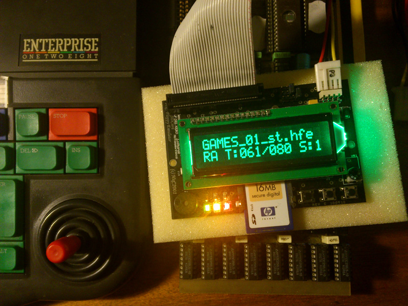

Then now I can use my spare 16MB card with HxC! :D

I created backup image of the FAT32 formated empty 16MB card, then next time enought write back this image not needed use FreeDOS again.
