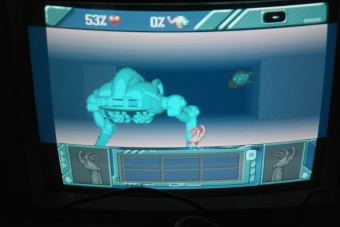

amigamiga
Posts: 17
Joined: Sat Nov 26, 2011 7:35 pm
Re: Problem in some games!
Post by amigamiga »
Yes, they work. :)
