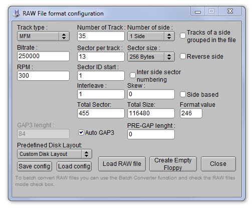

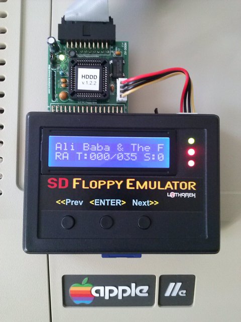

I'm trying to hook up my recently acquired Apple IIe with the SD-Floppy-Emulator, but I'm running into problems. Most probably it's just a question of (raw-) converting existing Apple disk images.
I know the Apple disk format is 35 tracks/13 or 16 sectors/256 bytes/300 rpm, but I have no idea about the other settings such as track type, bit rate, interleave, skew etc.
Here's what I'm hooking the HxC up with:
http://www.bootzero.com/HDDD_A2_v1.2/HDDD_A2v1.2.html (You can find a user manual there as well.)
I'm pretty sure this would work. From the photo you can see that the HxC is actually reading from Disc Drive A. (Tried all the various jumper setting as well, of course.)
I've uploaded two Apple II disk images here (re-directs to Wetransfer): http://tinyurl.com/csej2t7
Maybe one of you can point me into the right direction as to what setting I should use when converting these images to .hfe.

Hi Jeff!Jeff wrote: Waiting for feedbacks.
I just tried your .hfe image, but it's just the same as before.
Any more ideas?

So there is some software to write to add this FM layer. Should not be a big problem, but i need more details on how this FM encoding is done.

Just retry this :800XL wrote:Is there anything I can do to help?
https://hxc2001.com/download/floppy_driv ... xC_Try.zip
i just added 2 images with encoded with the guessed HDDD A2 format.
Re: Apple IIe with HDDD and HxC
SUCCESS!!!
Double step it is!
So, how do I convert A2 images now? Do you need to write an update for the Emulator Software? And will this work with all A2 images or just with .nib files?
Anyway thanks a lot, Jeff! *thumbs up*
Double step it is!
