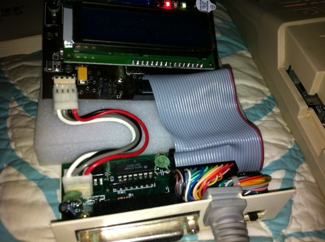

- I've gutted an external floppy drive and put in an HxC SD emulator.
- I've installed an alfa data boot selector so I can switch the external drive to DF0.
- the HxC is set to handle drive A and B via the jumpers.
- Autoboot.hfe boots up fine, but I can't get any actual game HFE to load. It just flips back and forth from track 0 to 1.
- The HxC emulator works fine when I replace the actual internal floppy, but no luck when plugged in externally.
Anyone been through this process? Would love some help!

More info
Re: A500: hxc as external df0
Try ID1A.

Hah! Amazing. It worked! You are my hero.
