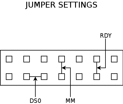

I have purchased a Revision F of the SD Floppy Emulator, and I am trying to get it working with a Roland MC-50 sequencer. I removed the original floppy drive, which was a Chinon FZ-354. The drive had the following diagram for the jumper settings:
The actual jumper settings were:
