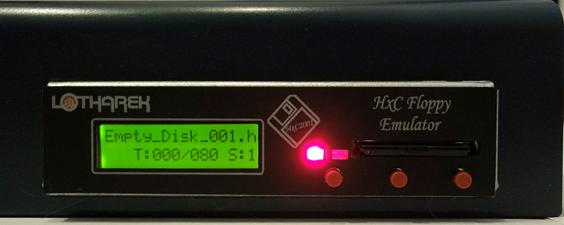

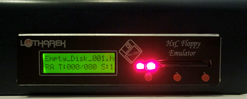

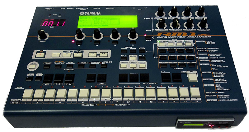

Yamaha RM1x with integrated Flobby emulator. (overview)
Yamaha RM1x with integrated Flobby emulator. (SDHC card in use; flobby file mounted)
Yamaha RM1x with integrated Flobby emulator. (writing to SDHC card)
