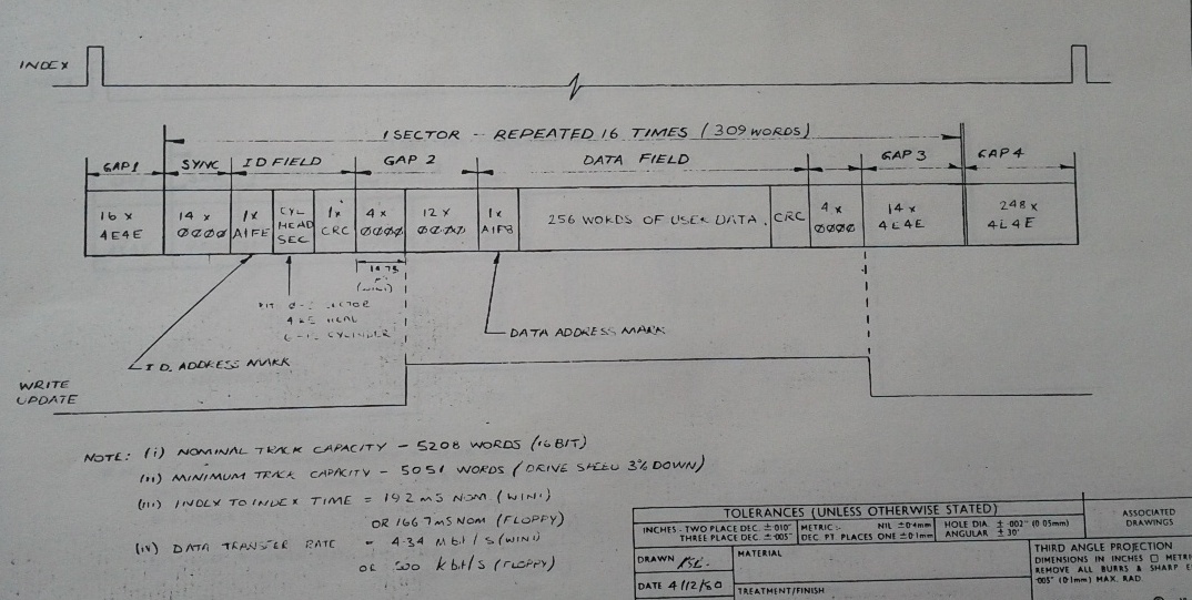

Hello
I am looking for an emulator for a Shugart SA851 8inch floppy drive and found your project.
There are over 800 disks which we need to emulate and all of them are read only. So I think the USB HxC attachted to a PC where the images are stored would be a good solution.
I Have a few questions to you:
1. To create the floppy images we cannot use one of your emulators but we need to attatch the floppy drive to a PC and then use any floppy dump software - correct?
2. Unfortunately we don't have a lot information about how the data is stored on the disks. It is a double density (MFM), double sided disk with 77 tracks and 32 hard sectors but fortunately is is treated as a soft sectored disk with 16 sectors so we don't need the SECTOR signal at the disk controller. The disk capacity is 1.2MB (1.6MB without sector formatting). In the attachment you can find a specification about the sector format. Can this format be emulated with your USB HxC?
4. The SA851has a 50pin interface but in our opinion this should work with the corresponding adaptor - can you confirm that?
If you need any other information about the floppy drive or the disk format to answer my questions - just let me know.
Kind regards
Markus

- SA851_Sector_Format.jpg (197.19 KiB) Viewed 19476 times

> Hi,
>> software - correct?
> Yes. To do this you can use the hxc software or ImageDisk software.
> But this will only work if the sectors are in the IBM/ISO FM or MFM format.
> The other solution is to use an KryoFlux for very special format disk to
> make a pulse-per-pulse copy.
> Regarding the sector format, this one is very similar to the standard FM
> format, but the Index/Data mark look differents (A1FE / A1F8).
> To be tested on a PC : The dump may work if the missing clock are the same
> as the standard : 0xC7
> What is the FDC used by your machine ?
> Since the HxC is working at the pulse level, yes the HxC can emulate this.
> Yes no problem. The HxC already replace some 8" disk drive.
> Best Regards,
> Jean-François DEL NERO

I doesn't look like it is IBM/ISO format so I doubt that it works with a standard PC FDC. I already posted in the Kryoflux forum.>> 1. To create the floppy images we cannot use one of your emulators but
>> software - correct?
> make a pulse-per-pulse copy..
The FDC is not a standard one, it is integrated in an old PCB testing equipment from the 70ies manufactured my Membrain/Schlumberger and build up with stanard logic gates. I could provide schematics but I don't think this would help. Most of the low level formating is done by the CPU anyway.> Regarding the sector format, this one is very similar to the standard FM
Regards
Markus
