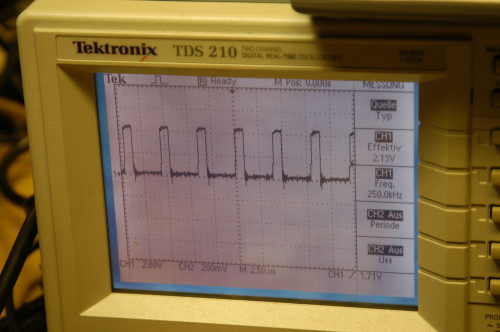

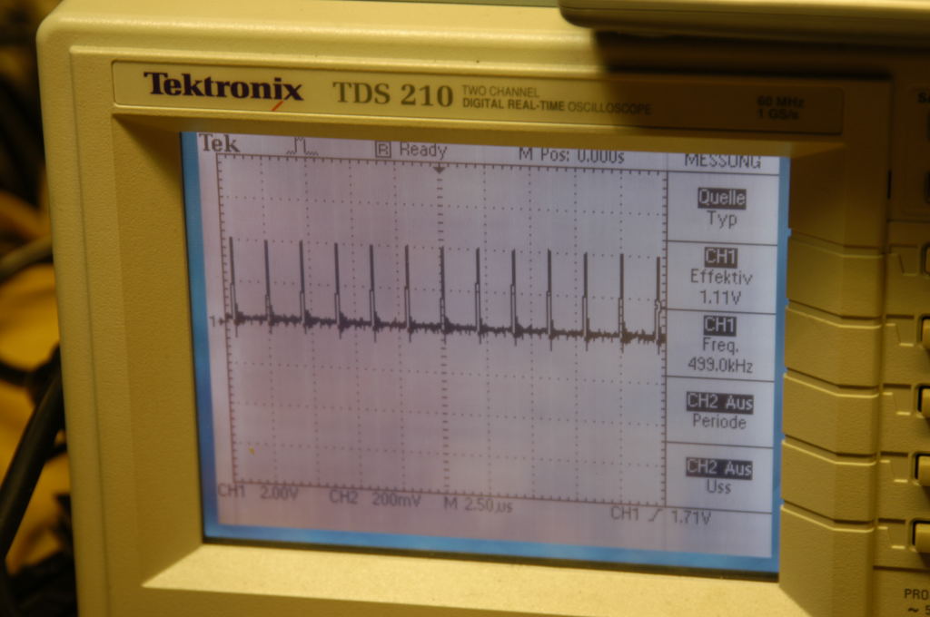

attached some pictures from the different timing of the real 8" drive and the SDHxC.
Both uses the same imd file as source.
- 8inch_data_after_sep_.jpg (77.67 KiB) Viewed 36345 times
- 8inch_data_org_.jpg (82.28 KiB) Viewed 36345 times

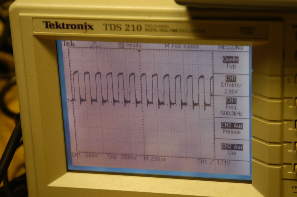

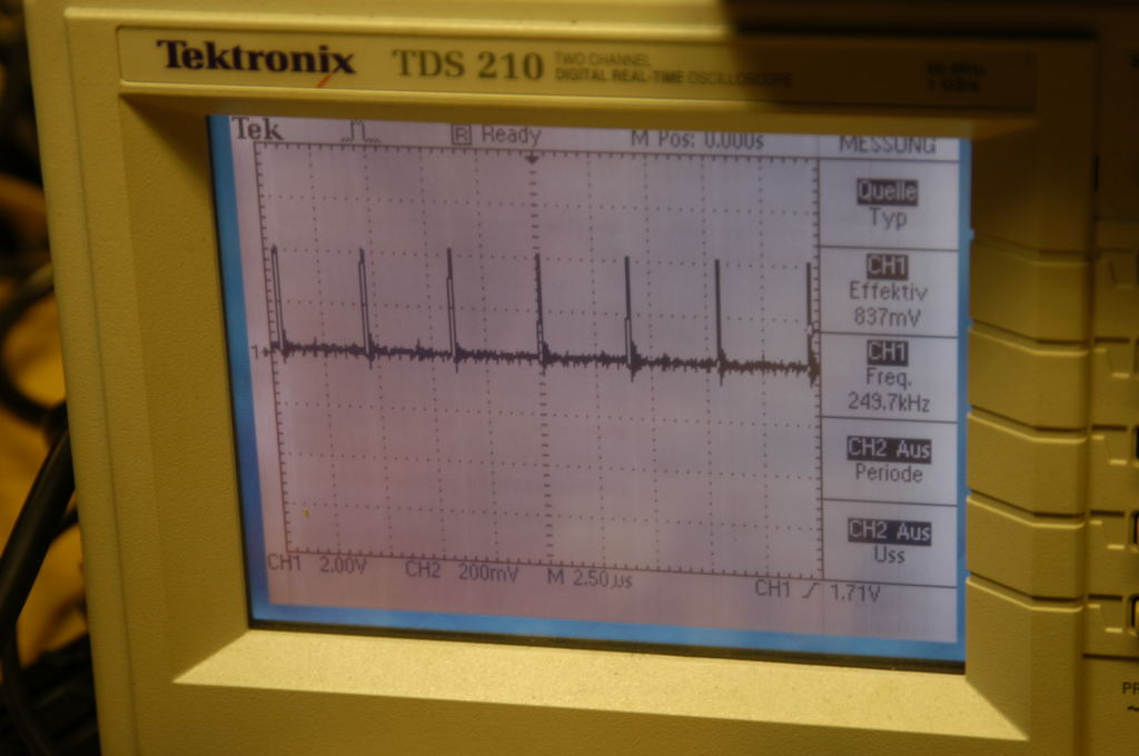

Re: SDHxC to emulate a IBM3740 Format?
And here the pictures from HxC.
- HxC_data_after_sep_.jpg (82.34 KiB) Viewed 36345 times
- HxC_data_org_.jpg (81.86 KiB) Viewed 36345 times
It seems that the VFO/data separator work in both case.
Regarding the data width difference , this probably because the HxC use a larger data pulse than the floppy disk drive.
Where have you took these measurement ? Right at the 1771 pins ? Can you take the VFO output clock too ?
what is the width of the floppy disk drive data pulses ?
Well, after a quick look at the 1771 / FD1165 datasheet and Ferguson Big Board schematic, i think that i have found the cause of the issue :Jeff wrote:It seems that the VFO/data separator work in both case.
In external VFO mode the 1771 wait data and clock pulses from the VFO with a width under 350ns (150ns<>350ns).
The FD1165 generate data pulses with a width under 250ns (200ns +/- 50ns).
all ok... but:
The problem is that the Ferguson Big Board don't have the monostable circuit generaly used at the data input. So if the the data width pulses are wider than 350ns, the 1771 is not supposed to work correctly.
So the possibilites to get this work are :
- add a monostable circuit to reduce the data pulses under 350ns.
( this maybe done by a simple resistor/capacitor circuit :
http://www.premiumorange.com/daniel.rob ... stable.gif)
Or
- try to bypass Ferguson Big Board VFO and turn 1771 in internal VFO/data separator mode (XTDS = 1). It can support pulses up to 1000ns in this mode.

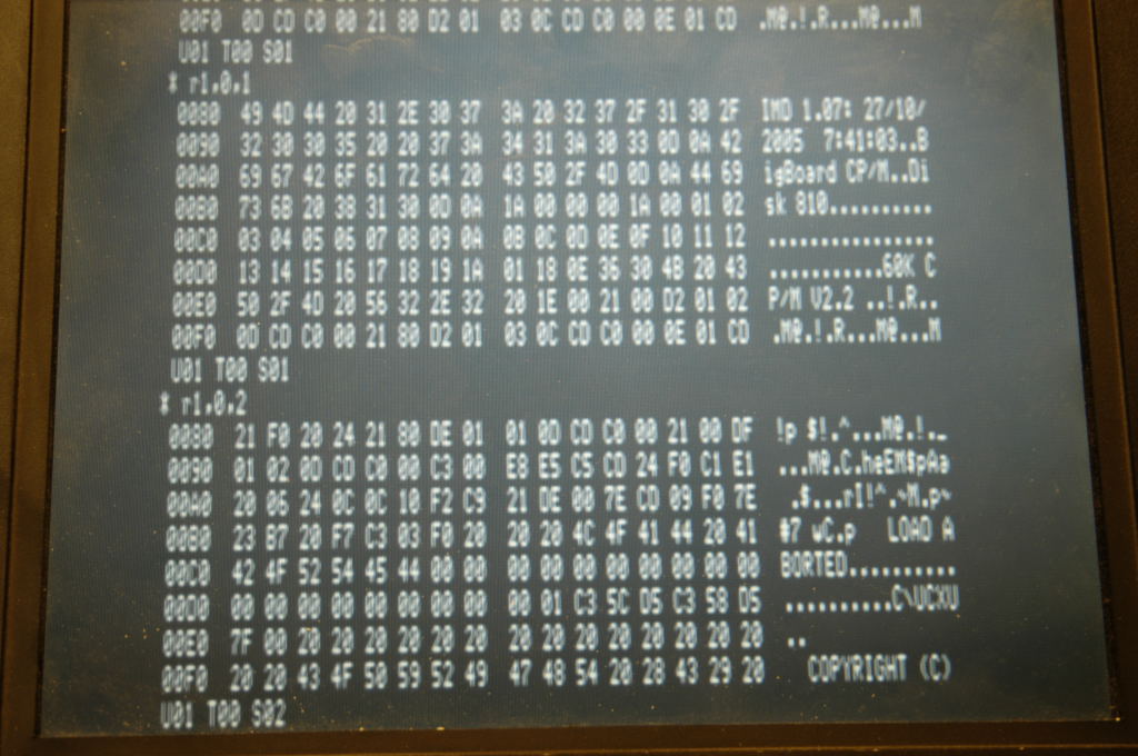

the shorting of the pulswide is working now over a 74LS123 up to about 450ns.
I am now able to read the contents from a "empty disk", created with the right parameters (all tracks, all sectors).
When i export the BB1.imd over "LOAD" and the export it to the SD-card, then i am only able to read track 0.
With the right parameters and "LOAD RAW" the BB1.imd and then export to SD-card, i am able to read all tracks with the right content.
Is there a way to convert the *.imd files to a *.raw file?
Frank
PS:The file BBCPM.IMD is not loadable in the software, why? Creating a real disk with IMD.COM has no problem with the BBCPM.IMD.
Frank
- wrong data.jpg (125.44 KiB) Viewed 36335 times
When i "reimport" the BB1_IMD.hfe in the new 2.xx HxC-Software and look on the datas in the sectors,
they are indentically in track 0 and in track 1. Also in track 2 and 3 and so on....
Frank
Frank
Frank wrote:Hi Jeff,
Frank
First it's good to see that you managed to get working the emulator.
Just change the file header to "IMD 1.07:".Frank wrote: PS:The file BBCPM.IMD is not loadable in the software, why? Creating a real disk with IMD.COM has no problem with the BBCPM.IMD.
yes : export them the img file format.Frank wrote: Is there a way to convert the *.imd files to a *.raw file?
mhh i don't reproduce the issue here. Have you the last software ?Frank wrote:When i "reimport" the BB1_IMD.hfe in the new 2.xx HxC-Software and look on the datas in the sectors,
Frank
Do you have activated the double step mode ? You shouldn't do this for this system.
