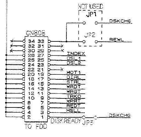

Please see the attachment "xh200-pin.png". This is the pinout as it appears in the technical manual. Sorry for the not-so-good quality. It's a PDF. If needed, I can post the schematic of the entire FDD controller. After I learned about Shugart, it seems the organ has the pinout in reverse. I assume it can be fixed by just taking the notch off the cable and putting it in upside down into the controller. (The original drive that came with the Hammond actually has the connector and cable mounted upside down as compared to a normal IBM drive. Maybe that's normal for Shugart drives, I don't know.)
For your convenience, I've already reversed the pinout of the controller. In brackets, I've noted what I think the pin stands for. Please see attachment "xh200-pin.png". It looks quite Shugart-y to me, except:
1. It seems Pin2 can be either jumpered to DISK CHANGE as in Shugart, or DENSITY as in IBM, but the drawing says that the organ does not use this pin.
2. It seems Pin34 can be jumpered to either expect DISK READY as in Shugart, or DISK CHANGE as in IBM, using a jumper called JP5 (of JP8?).
3. Pin14 often has a DRIVE SELECT3 in Shugart pinout schematics, but it's not used in the organ. The instrument only has one drive.
I do not know if my assumptions about the possibility of changing the behaviour pin2 and 34 are correct. I never took a look at the XH-200 floppy controller and never tried it. If the organ does something weird, like DISK READY *and* DISK CHANGE on pin34, can the emulator handle this? Even while not using pin2, it can detect disk changes, as it immediately displays the "LOAD DISK" screen when I insert a floppy, and it disappears when I take it out.
The emulator seems to have "Atari Shugart", and "SP1200 Shugart"; if necessary, can the emulator also get a "Hammond XH/XT Shugart" option? I'll first try with Generic Shugart, of course, and I'm willing to test a new option of necessary.

As far i can see, this should work without any problem.
the shugart mode should be ok.
