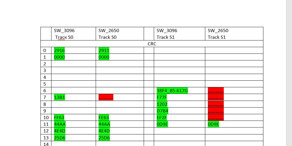

Using Kryoflux, I got the contents of 2 system floppy disks( Raw.file), damaged tracks are marked in red. I took a good track (green) and inserted it instead of a faulty track. Then I wrote the recovered sw3096 file and sw2650 file to floppy floppy disks using Kryoflux.
Vasiliy
pismerovvasb1
- Posts: 5
- Joined: Wed Dec 18, 2024 10:16 am
Re: Arburg Multronica

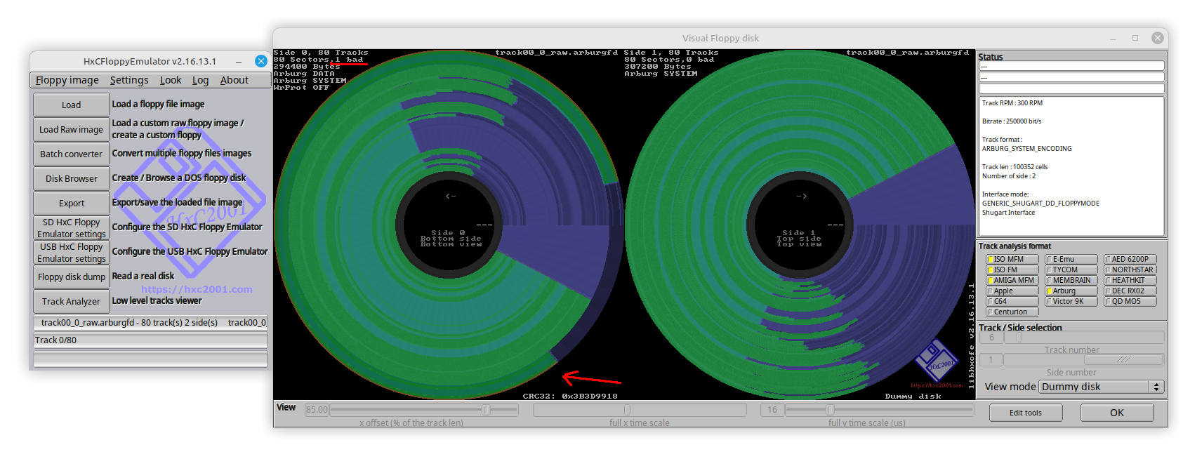

1 - Dump the floppy disk with any stream dumper (kryoflux for example). You will have raw or scp "stream" files
2 - Start the HxC Software
3 - Load the stream file (Button "Load")
4 - Once done have a look the the track viewer (Button "Track Analyzer"). Set "Arburg"
If your floppy is in perfect good state, you should have something like this :

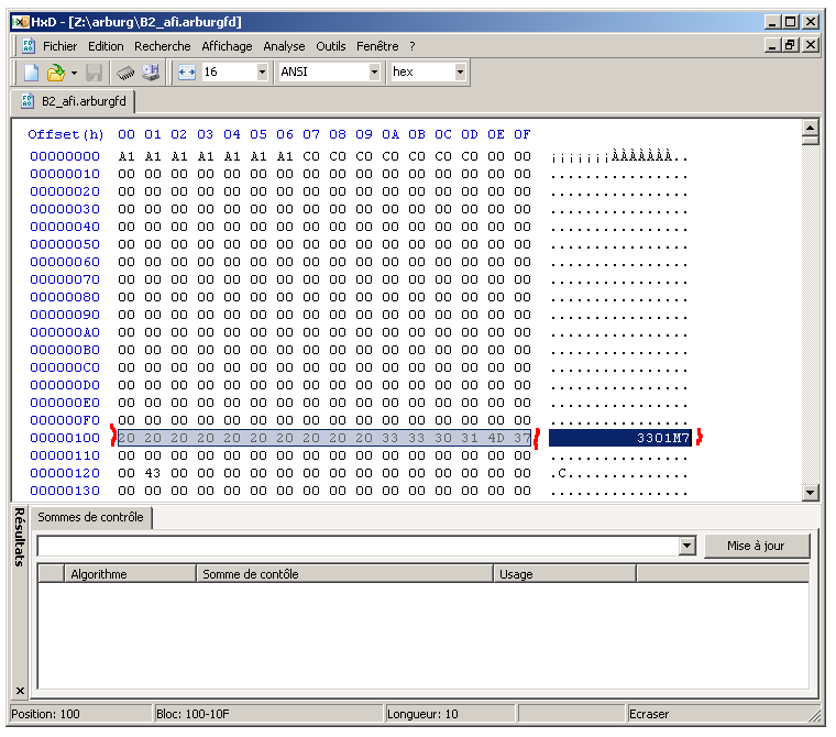

6 - You now have an arburgfd file. This is a decoded file of the floppy disk content.
At this point and if needed, you can modify this file to edit the serial number for example.
For this you can use an hexadecimal editor.
The serial number is at the offset 0x100 :

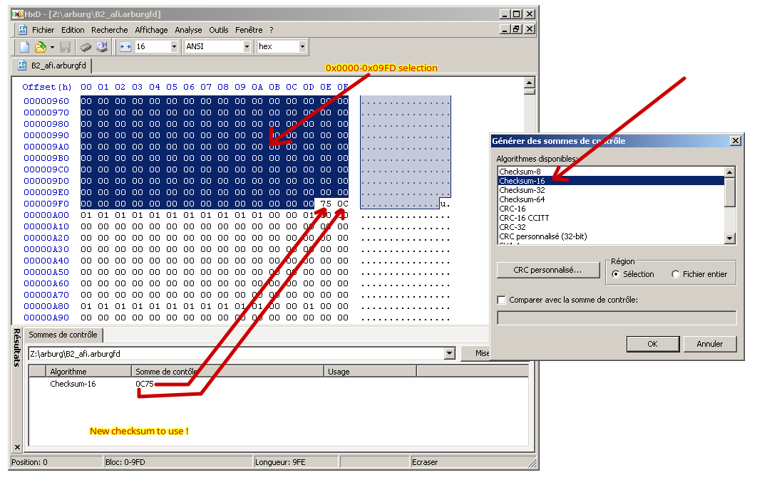

Don't forget that once you have altered the track data, you have to change/fix the track checkum ! :
The 16 bits checksum number is at the end of each track.
For this you can use the hexadecimal editor tools to fix the checksum : Select the data area (0x000<>0x9FD) -> Tools -> 16 bits checksum.
Then save the file.

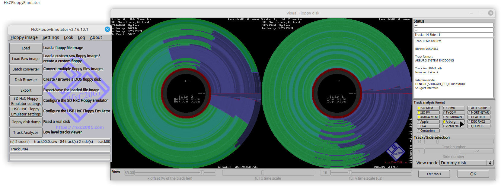

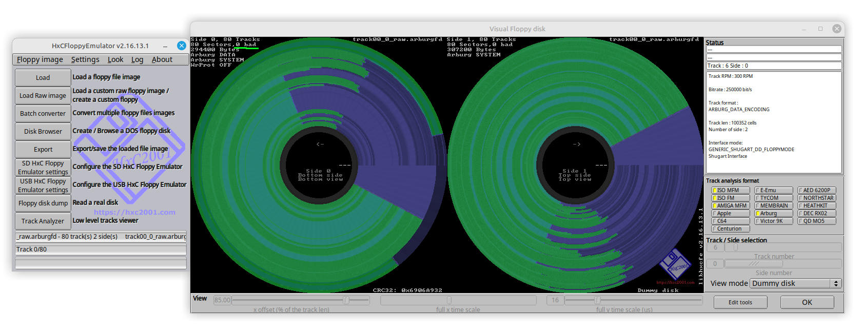

7 - Back to the HxC Floppy Emulator software. Load the arburgfd file. Go to the "Track Analyzer" window.
If you have successfully modified the file with the right checksum / or not modified at all the file should have something like this with 0 bad sector :
If you fail at the modification :
In this case you have restart and try again.
If all is ok - you can export the disk to different format :
