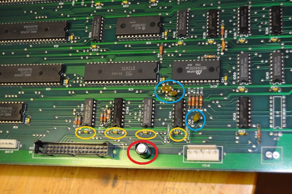

On Synthzone i read a post said something about Capacitor Problems in Conjunction with "Bad Data from Disk..." so i decided to exchange the 470 Elko (Marked Red in the Picture).
No Luck.
You Think i should try to exchange the small ones marked yellow in the Picture or the ones marked blue?
I don´t think that the Type of Capacitor (small ones) marked yellow do fail that often.
The ones Marked Blue, i don´t know about.
What do you think?
Capacitor Circus
Capacitor Circus
