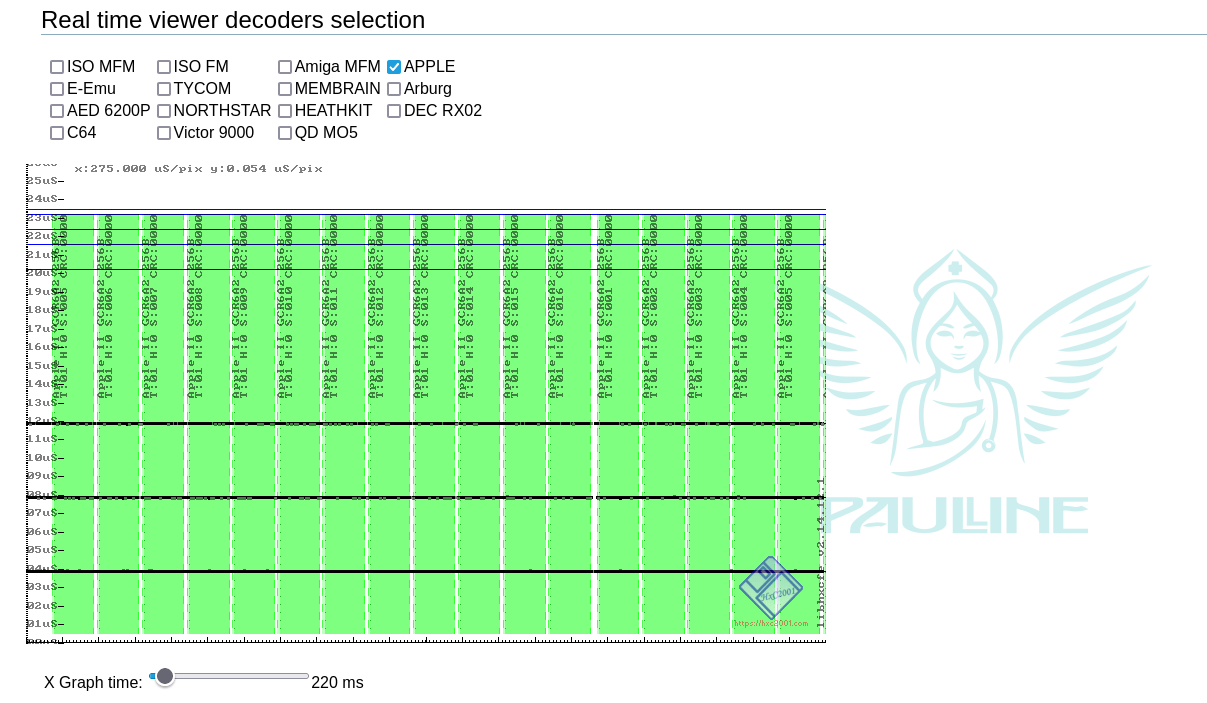

Still some points to finish, but the dsk/po/do direct support is almost there ! :D
Here is some Apple II sectors generated by the gotek seen by the Pauline dumper :
Screenshot at 2024-05-30 00-38-12.png (87.19 KiB) Viewed 45875 times
