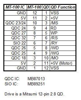

Jeff wrote: Sun Sep 22, 2019 5:49 pm Ok. The PR-100 pinout is the same as the S-10/S-220.
But i think that you have now the right pinout.
Knuckx wrote: Sun Sep 22, 2019 5:37 pm So quite a lot of frustration, a multimeter and a PR-100 (which is a very similar sequencer) service manual later we get this:
I can confirm that this pinout is correct and working to replace a 12 pin Mitsumi QD drive in a MT-100. All working correctly with a custom firmware build set for Roland QD mode, read and write.
Jeff, would you like a QD image written with an MT-100 (it should be the same as a PR-100, disk format wise)?

Knuckx wrote: Sat Sep 28, 2019 1:29 am I can confirm that this pinout is correct and working to replace a 12 pin Mitsumi QD drive in a MT-100. All working correctly with a custom firmware build set for Roland QD mode, read and write.
Super, thanks for the feedback ! :D
Yes i am interested by the image, for study and add its support to the QD toolkit software. You can send me it to hxc2001 at hxc2001.com
btw is the firmware working without the "Roland" option on the MT-100 ?

Jeff wrote: Sat Sep 28, 2019 10:02 am Yes i am interested by the image, for study and add its support to the QD toolkit software. You can send me it to hxc2001 at hxc2001.com
Emailed you an "empty" image and a recording of a classic MIDI file.
The firmware appears to work just as well with and without the Roland option, but I have only performed a quick test with the Roland option off (load, save, verify, check). I have returned to a firmware with the Roland option on following this testing.
