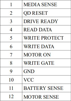

Have you a way to found the GND on the connector ( with a multimeter for example) ?
The only 12 pins QD pinout i found come from the Nintendo FDS drive. This drive is based on a Mitsumi QD drive, so this may match :
But to be "sure" check that the GND and +5V pins are matching with the above pinout.

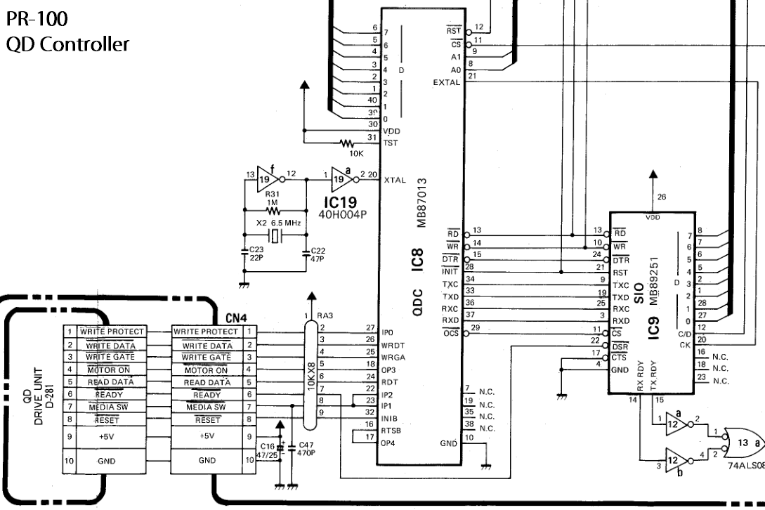

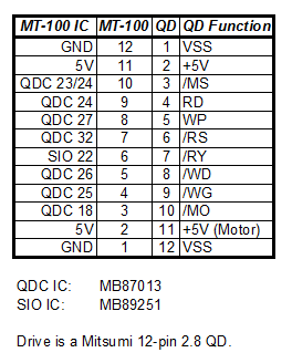

So quite a lot of frustration, a multimeter and a PR-100 (which is a very similar sequencer) service manual later we get this:
QD Pinout.PNG (12.8 KiB) Viewed 1439115 times
Yes, the connector pin numbers are back to front between the MT-100 and the QD drive. (Thanks Roland!)
Here's the PR-100 QD Controller circuit diagram (taken from the service notes) I worked from; both the ICs shown are present on the MT-100 as well.
PR-100 QDC.png (163.29 KiB) Viewed 1439115 times
I haven't tested this pinout as my Gotek hasn't arrived yet. I think this Mitsumi 12-pin drive is the same as that used in certain word processors (like this one: https://cromwell-intl.com/technical/qui ... overy.html).
Re: 2.8" QD Disk Emulation
Ok. The PR-100 pinout is the same as the S-10/S-220.
But i think that you have now the right pinout.

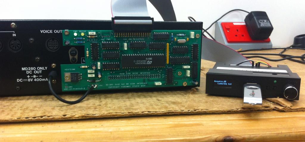

First test of the XD-280, a full Akai MD-280 QD unit replacement for the Akai S612 : Working out the box ! :D
XD-280 SN-000 cropped.jpg (69.3 KiB) Viewed 1439091 times
More details on gearslutz :
https://www.gearslutz.com/board/electro ... -s612.html
