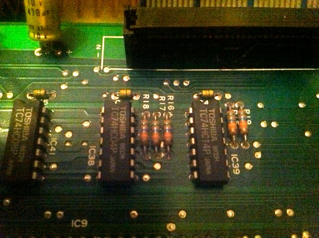

@Jeff : I found a post of you in another forum about changing a resistor. did you get some feedback, if it workes? I will try to change R18 on the S950 .
"Some News :
I just got the floppy interface schematic page of the S950. Unlike others system the S950 use 56K ohms pull up instead of 4.7K/1K pull up on floppy inputs lines (READDATA, INDEX,TRACK00,READY,DENSITY,...)
So there are no enough signal current on the data lines and this make the thing unreliable.
So try to add a 4.7K ohms pull up resistor between the line READDATA (line 30) and the +5V (you can do this mod on the S950, on the cable or on the HxC. This is as you want).
You can also change R18 on the S950 by a 4.7Kohms ;)"

No, no feedback. if you can make the test this would be great. just add a ~4.7k pull-up resistor on the data line /RDATA (wire 30 of the floppy cable).

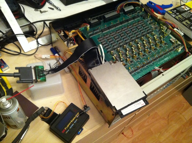

Here´s the feedback. It works. I found a 4,6kohms resistor in one of my boxes ;) . As I had the 950 open anyways , I exchanged R18 on the lower board. You will find R18 on the left side close to the floppyport.
Now I´ll try to build something for the external cased HxC. I think of modifying the RS 232C Port by connecting the floppycable. Outside I will use a SCSI cable . On the end of the SCSI, I´ll build an adapter (DSUB 25 to floppyplug) to the entry of the HxC.
There will be a switch to choose between the FD and the HxC
Let´s see how far I get ;)

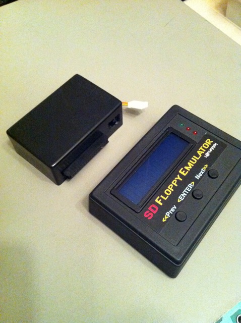

So just to confirm; swapping the resistor allows the HxC to work using a longer floppy cable?
I am planning on purchasing an external, boxed HxC and mounting this either on top of my S950 or to the side and running the cables through the ventilations grills after removing a small section.
Asides from the cable length issue which now appears to be resolved by the resistor mod, are there any other problems that I am likely to encounter?

That´s what´s up so far.
Check it out :)
I also did a little video about it. No saving here, but you can see me loading up stuff from the internal floppy and then from the HxC (external cased version)

Sometimes you still get a error message , that the disk is not formated (on both drives) . but if you press disk again, it works fine then.

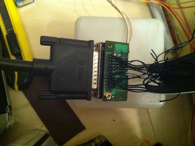

The connection of the switch was a little tricky this time. It´s connected to the RS 232 board. It also needs a little modification on the ribbon cable that leads to the internal drive.
When I have build up everything , I´ll send you more pics and a new video.

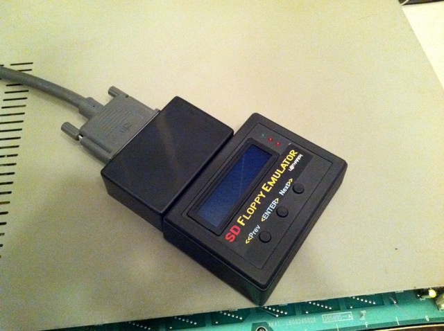

Here we are. External cased model of the HxC , connected over the modified serial port RS 232 via SCSI cable.
Checkt out the Video. Switch to choose between the drives is in the front of the 950.
http://www.youtube.com/watch?v=kYXwhYYvA2g
