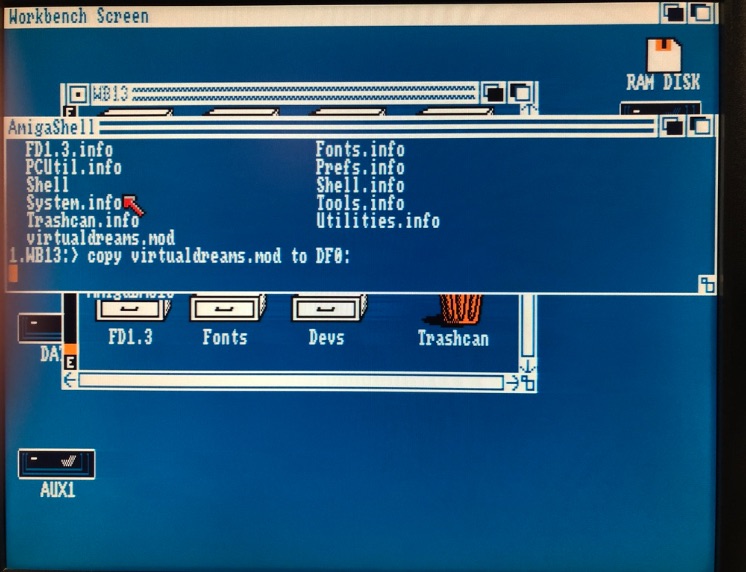

I've tested on my A2000
Still hear corruption in the MOD file
empty.adf.zip
(220.75 KiB) Downloaded 2040 times
I'm going to test on my A500 with ACA1234 disabled right now, will report in a moment

Changed to my A500 with the ACA500+ enabled but running 68000, ACA1234 68030 disabled, soooo slow :)
- Wrote the same MOD to a new empty.adf
- Played it back, still corrupt, but different
- Sending the file
empty500.adf.zip
(219.73 KiB) Downloaded 2053 times
This is the Amiga that can write on the old Gotek with old firmware no problem.
You know there is one more thing I can do here...
I can use the ACA500+ to boot into my AmigaOS 1.3 \ KS1.3 partition and try writing to the Artery Gotek from there to see if this is an OS\KS related issue
Will take a bit of time to set that up

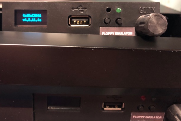

v4.2.11.4a
just some alignments changed. let me know if this change anything for you. (this still working here)

I have news !
Here is the file generated by your newest firmware on my A2000 running AmigaOS 3.2
empty_v4.adf.zip
(221.03 KiB) Downloaded 2051 times
It's still corrupt..
