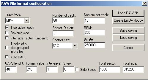

Just received the fine cased cersion of SDCard HxC Floppy Emulator today. I managed to connect the cables, jump the jumpers and convert the OS disk img to hfe as well as to load the OS into EPS16+ (the rack version). Oh, it took some time (I guess there's no single instruction sheet/manual containing all of the steps above for the noob...), but finally the OS loads - and I'm so happy!
After that it's been just "DISK NOT FORMATTED" with each of the sound disk hfes. I've tried to alter some of the emulator (1.6.8.1) Load raw file format configuration settings to no avail. The screenshot shows the one used for the OS hfe (that seems to work).
Where am I going wrong?

screenshot of the load raw settings
load raw 1.jpg (28.34 KiB) Viewed 13453 times

Which sound file image are using ?
