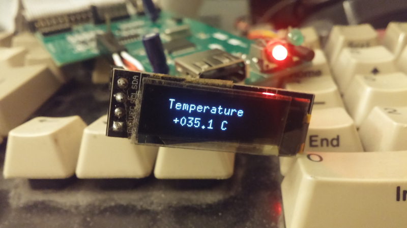

10 June 2019 : Firmware STM32 USB HxCFloppyEmulator v3.2.3.1a ( -> In the "WIP_Firmware" Folder and https://hxc2001.com/custom_fw/)
- On-die STM32 temperature sensor support : You can get the current CPU core temperature from the embedded menu :
press both buttons to enter the menu. Choose "temperature" or "E " if you have the original 7 segments display.
- Blackberry trackball : Sensitivity reduced/better usability.
HXCFEUSB_HFE_beta_firmware.zip

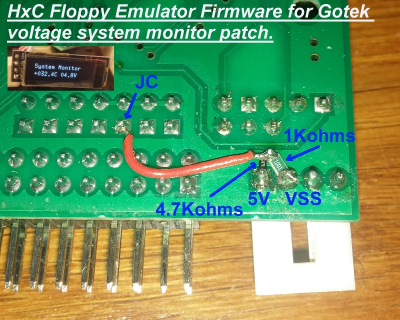

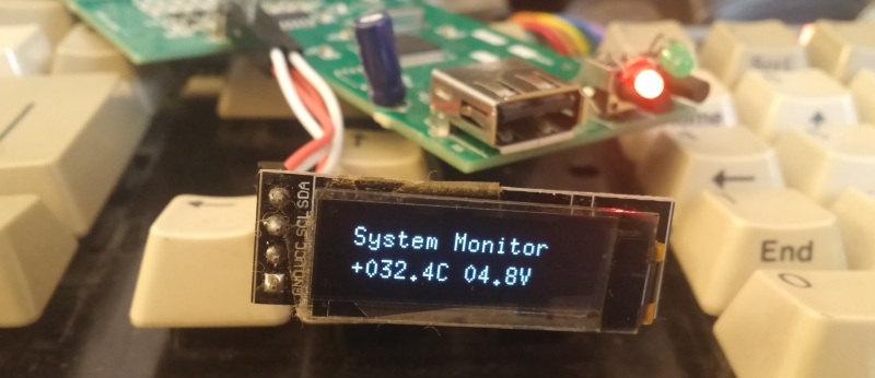

12 June 2019 : Firmware STM32 USB HxCFloppyEmulator v3.2.4.1a ( -> In the "WIP_Firmware" Folder and https://hxc2001.com/custom_fw/)
- Power supply voltage measurement :
You can now see/read the power supply voltage incoming to the floppy emulator.
This feature is quite useful to check the machine power supply state/working condition.
If you want to use this feature you must add this voltage divider to measure
the power supply on the JC jumper input :
VSS/GND|---| 1Ko Resistor |--(JC pin)--| 4.7Ko Resistor |---< 5V Power Supply input.
(See https://hxc2001.com/download/floppy_dri ... onitor.jpg)
Notes :
- Use +/-1% Resistors if possible.
- This voltage divider support up to 18V.
Use the embedded menu to access the system monitor :
Press both buttons to enter the menu. Choose "System Monitor" or "E " if you have the original 7 segments display.
- "Temperature" menu renamed "System Monitor".
