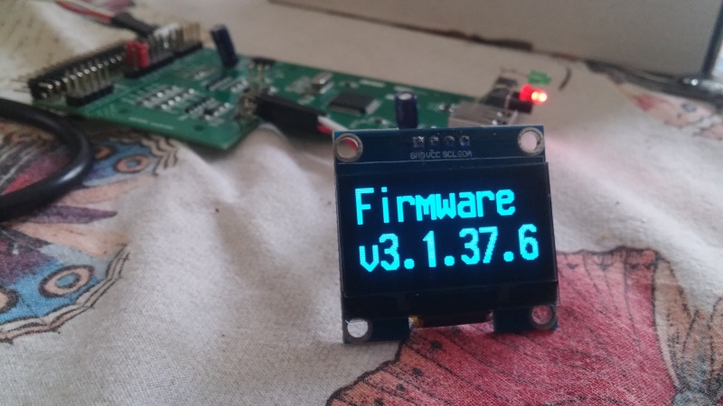

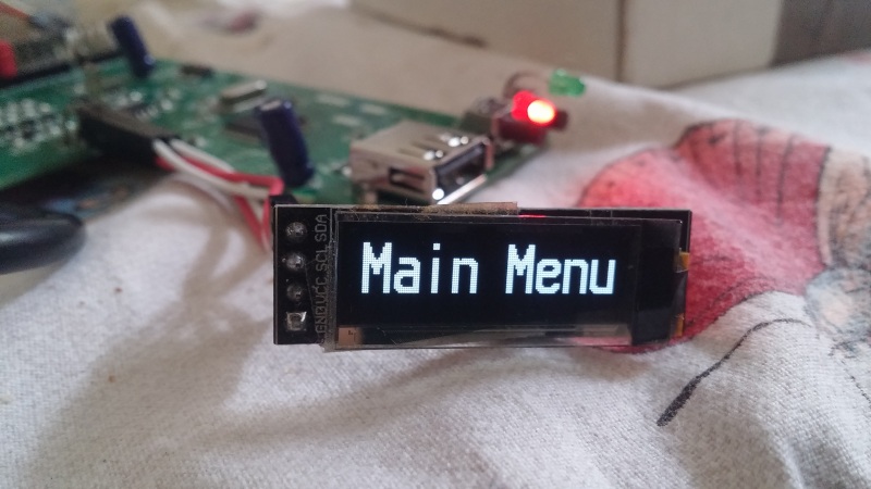

Re: New Alpha version Firmware - Volunteer Testers needed !
v3.1.37.6a : More OLED screens supported and more nice & big fonts available, plus some fixes !
Available on the custom firmware page:

6 March 2019 : Firmware STM32 USB HxCFloppyEmulator v3.1.37.8a ( -> In the "WIP_Firmware" Folder and https://hxc2001.com/custom_fw/)
- More customization options :
- 16 different oled graphic fonts available.
- New oled screen models supported (128x32,128x64, SSD1306, SH1106...).
- Default raw system selection.
- And many more new options : sound volume, auto select delay, ...
