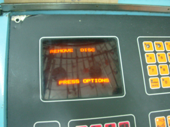

Re: Problem floppy emualator for CNC machine
Session 1
- jumberca6_1.png (186.77 KiB) Viewed 35929 times
- jumberca3_1.png (169.21 KiB) Viewed 35929 times
- jumberca1_1.png (181.91 KiB) Viewed 35929 times

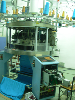

Session 2
- jumberca floppy emulator_1.png (149.47 KiB) Viewed 35929 times
- jumberca8_1.png (182.02 KiB) Viewed 35929 times
- jumberca7_1.png (162.19 KiB) Viewed 35929 times

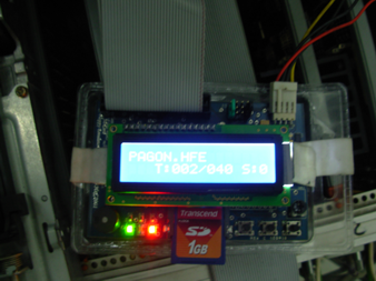

Session 3
- replace jumberca floppy_1.png (171.11 KiB) Viewed 35929 times
- replace jumberca floppy2_1.png (177.94 KiB) Viewed 35929 times

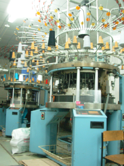

We on the contrary, sought a low speed, then the data is transferred without errors. In the "floppy emulator setting " indicated "IBM PC 720 kb ". In all other modes to read faster and get error in knitting porgram.

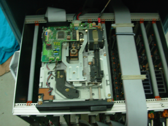

I have a problem.

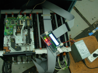

The old computer at which was installed the HxC floppy emulator, has been replaced by more modern
After replacing the computer I could not write data to a floppy disk emulator installed on new computer but all worked on the old computer correctly
Differences from the old computer and new computer is:
1) support only a single floppy (A).
2) higher productivity.
3) Additional Information:
version of the firmware emulator «V1_6_1_1B»;
emulator connected via a twisted cable; ( A mode )
in the bios of the the computer floppy listed as 5.25 1.2 m; (A mode )
Jumper is setting in the following way
PS:
with a real, floppy 5 "25 disk driver everything is working properly
waiting for your advice
with best regards
Slava
Can you access the floppy emulator with this new PC ? (can you read the disk?)seaman_2007 wrote:Hi Jeff!
How are you?

Did you see something special on the HxC LCD when you try write on the HxC ?

I moved to the sd-card pre-prepared image (located in the attached file), working from the command line under real DOS, OS was not able to access the floppy A:, the system turned to HxC floppy emulator (on the LCD message was RA).
I did check, transferred to the card images of floppy disks 3,5 '1,44 M and 5.25 M 1.2, OS appealed to the HxC Floppy emulatoru no errors!
Unfortunately CNC machine can only work with a floppy drive 5.25 ".
Configuration of jumpers in the A:/ twisted cable.
I want to emphasize that earlier this image worked on the old machine with no problems.
The difference was previously installed as drive B :/ on a direct cable, configuration jumpers
«Vfd_hxc» I can not use because the program runs under pure DOS.
It makes no sense to send you the program because it requires a hardware dongle (hardlock).
Waiting for your advice.
seaman_2007 wrote: I did check, transferred to the card images of floppy disks 3,5 '1,44 M and 5.25 M 1.2, OS appealed to the HxC Floppy emulatoru no errors!
So you can read 1.44MB disk image with the HxC on this new PC ?
In this case this probably an double or single step issue. (Bios issue in fact...)
Try the attached disk image on the pc.
