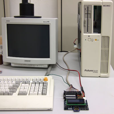

Can i have a picture of this computer with the hxc ? (or if you can a small video?)
I'll upload a small one and email the large version. -b-

May I ask what adaptator you're using to connect the floppy cable to the HxC ?
Is the original drive an external 8" drive ? So is your cable a scsi like one ?
If so what is the brand/model of the drive you replaced ?
Thanks :o
by the way, great machine ! This is the first time I see this model.

Namida88 wrote:May I ask what adaptator you're using to connect the floppy cable to the HxC ?
Thanks :o
As far i can see this is a hand made passive adapter.
I post some details that schadel send me by email :
I'll upload a small one and attach the large version here. Although you
can see an empty bay, the "B" drive is an 8" unit in a separate
enclosure. The 5.25" HD & 8" DD both use the same NEC 72065 FDC, but
they have separate drivers, receivers and cables. The computer controls
a scanning electron microscope used to measure critical dimensions on
75mm semiconductor wafers. The computer is behind the front panel so
that only the 8" drive is accessible to the user. To allow long file
names, the software uses two virtual drives of limited size on the HD
and one on the "B" drive. So the Floppy Emulator will replace the 8"
drive and accommodate many more application files.
The pinout at the drive end of the cable is different from any other
drive I could find documentation for. I had to trace signals back
through the drivers & receivers to correlate them with the known pinout
at the 5.25" drive.
Some mechanical work remains to be done but I will turn that over to
someone else. Power will be off in the lab this weekend. I don't know if
I will get a chance to take a better picture.
Thanks again,
