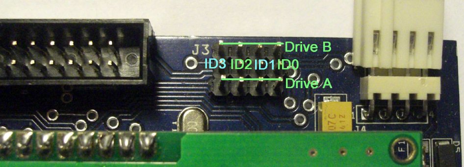

ferdji wrote:Image
Are you using a twisted floppy cable ? If no, move the jumper to the "ID0 Drive A" position :

I understand now. My problem was from my floppy cable.
If i use the orginal one no probs. With the cable extends, problems appears.
Thanks Jeff.
I mean the new cable was too long, informations could not be read correctly.
