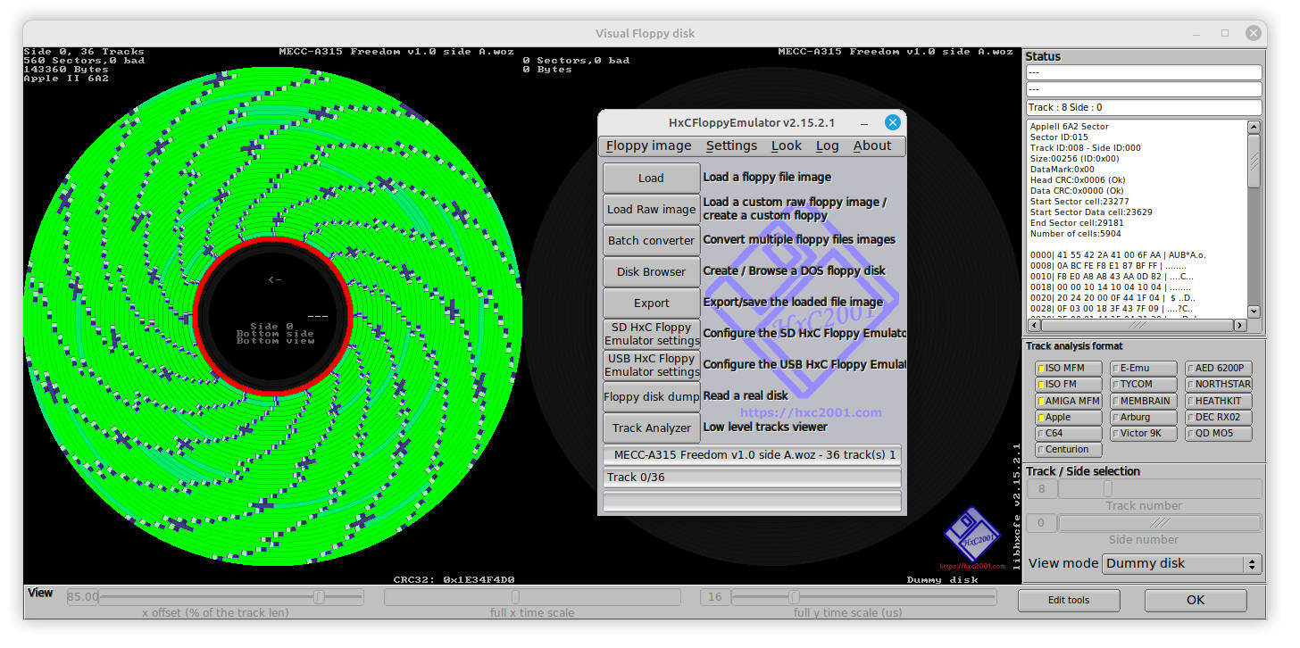

Re: Apple II Support
Not tested yet against the Gotek HxC Apple II firmware but the HxC tool now support WOZ files ;) :
Screenshot at 2023-12-25 14-18-50.jpg (237.58 KiB) Viewed 36256 times

Jeff wrote: Mon Dec 25, 2023 3:33 pm Not tested yet against the Gotek HxC Apple II firmware but the HxC tool now support WOZ files ;) :
Any progress is good progress! Thank you and Merry Christmas!
