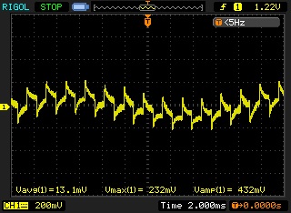

quartz pic18
quartz pic18

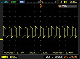

pin2,5,6 23k256
pin2,5,6 23k256

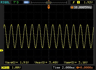

pin1 23k256
pin1 23k256
Re: HELP! SecSerialBridge software - ends with an error.
First pic : OK
Second pic : KO
Third pic : OK

It can be more specific. What is wrong with 2 drawing. PIC18F defective?
ncbelov wrote: Mon Feb 10, 2020 5:04 am It can be more specific. What is wrong with 2 drawing. PIC18F defective?
No. The lines are floating : Something is probably not connected (bad solder ?).

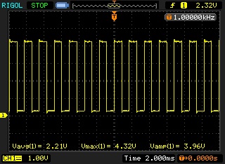

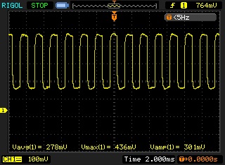

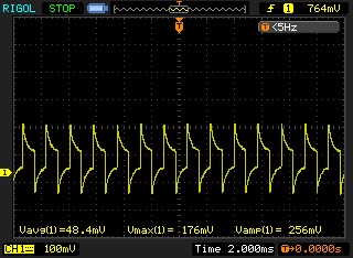

New dimensions.
pin2 23k256
pin2 23k256
pin6 23k256
pin6 23k256
pin5 23k256
pin5 23k256
ncbelov wrote: Mon Feb 10, 2020 5:00 pm New dimensions.
100mV is definitively too low. And the pin5 and pin6 seems to be inverted ?
Can you show me the pin 1 behavior from the power up during ~2 seconds ?
ncbelov
Posts: 13
Joined: Thu Feb 06, 2020 12:43 am
Post by ncbelov »
100mV is very small. 5 and 6 pins are not mixed up.
1 time I managed to download the firmware up to 34%. I had to reset the freeze process.
Now the device is not detected on the server.
