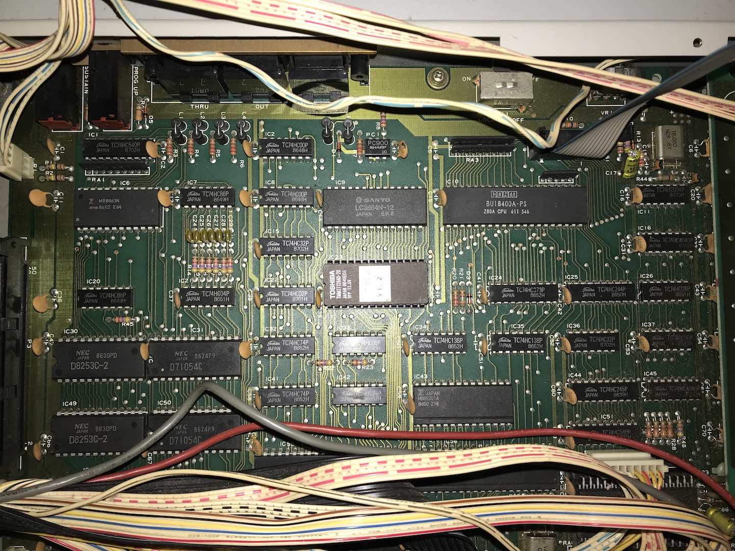

The x7000 format appears to be very different to the s612 format... Can you take a good quality picture of the cpu board ? I want to see which controller is used.hoby wrote: Tue Sep 10, 2019 6:43 pm I installed v3.4.4.6a, and loaded the flute sound. It worked fine, and takes about 7 seconds.

Sure, this is the best quality I can upload here, the original is better if you need itJeff wrote: Tue Sep 10, 2019 7:31 pm
- IMG_5001_1.jpg (238.45 KiB) Viewed 77680 times
Re: 2.8" QD Disk Emulation
Yes send me it to hxc2001 at hxc2001.comhoby wrote: Tue Sep 10, 2019 8:00 pmSure, this is the best quality I can upload here, the original is better if you need itJeff wrote: Tue Sep 10, 2019 7:31 pm

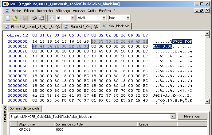

Ok i have checked your file : The x7000 use the S700 QD format, not the S612 format.
And the good news is that the whole track CRC is valid (=All data valid) so hopefully this should not be too hard to fix it.
