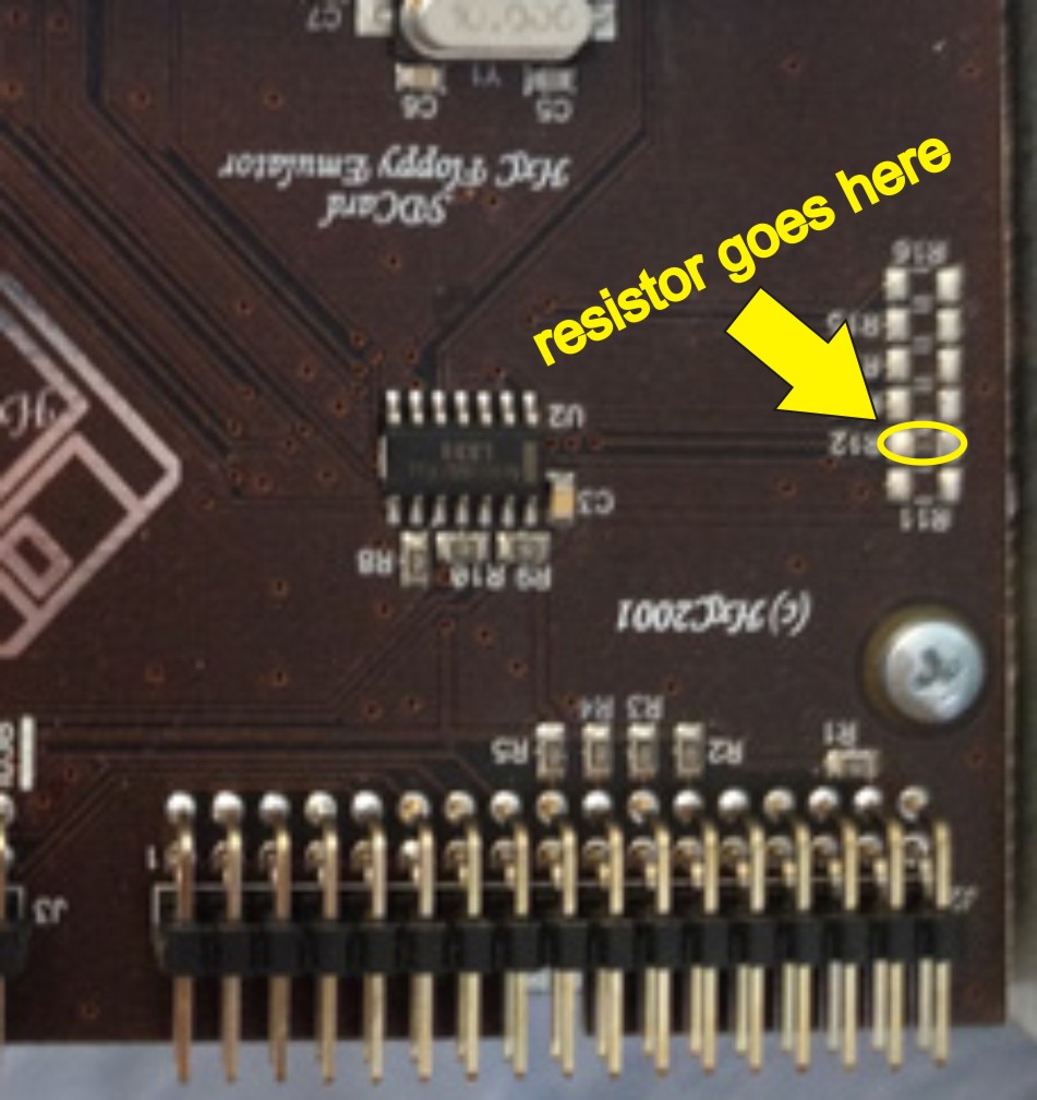

You need to put an 2.2k resistor at the R12 place on the rev f board (near the floppy connector).
1/2 Watt is really big. the place is done for 1206 SMC part, but if you don't have access to this kind of part, this is doable with an 1/4W resistor.

ok so is doable with 1/4 watt surface mount, what is the correct wattage?? I can get 1/4 watt and 1/8 watt
and just to be sure is the attached picture correct for where the resistor goes?

Any wattage is ok.
Yes this is this place.

the resistor 2.2 k ohm, on r 12...

I bought the Akai s950 sampler, and hxc floppy emulator rev f. I have removed the old floppy disk drive, and put there the hxc floppy emulator. Then i have formatted the sd card to fat32 and loaded the configuration file on it. I have also loaded the s950 disk images. But - when i am trying to load the samples to my s950, it says: disk is unprepared, you must format it. The same situation is when im trying to save a sample or a program. What should i do? I heard about the resistor mod, but i dont know what is it about. What resistors do i have to buy (and how many of them)? Where should i put them? It would be nice if you explain it to me in really easy way - im really not good in electronic things like that.
[edit] I have found 2.2k ohm resistors to buy - how many watts they must have? I have to put them in ''place'' r12 in hxc floppy emulator?
