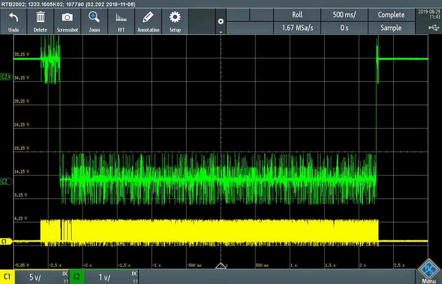

A read data test trace is attached, the Ready signal is lagging behind the read data, which is how its shown in the Timing Diagram. It also de-asserts before the read has completed.
Real QD - Ready and Read Data
RealQD - Read Cycle - Ready and Read Data .jpg (103.22 KiB) Viewed 26404 times

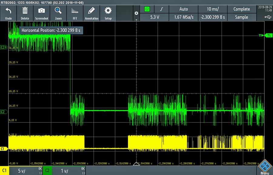

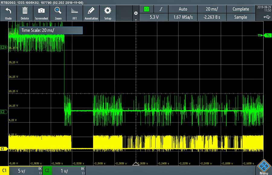

The Read cycle has a big pause of read data at the start followed by lots of smaller pauses before its a continuous data stream. I was not expected this...although the Timing Diagram does seem to show the main gap.
The read data is active as soon as the drive starts spinning (MO) and then Ready asserts, and the data keeps going for 7ms then stops for 20ms before getting into a read data stream which is not yet contiguous until 170ms.
Does the Gotek fw work in this way?
RealQD - Read Cycle Glitches Detail - Ready and Read Data .jpg (104.81 KiB) Viewed 26403 times
RealQD - Read Cycle Glitches - Ready and Read Data .jpg (107.25 KiB) Viewed 26403 times

AMSynths wrote: Thu Aug 29, 2019 12:55 pm The Read cycle has a big pause of read data at the start followed by lots of smaller pauses before its a continuous data stream. I was not expected this...although the Timing Diagram does seem to show the main gap.
That's interesting. But this is expected too : Because of the WG 168ms delay this part is probably not formatted and you read back noises. We can edit the track data in the QD file to mimic this if needed.
But i note that the real track data start is Ready + 168ms. I have a similar delay with the MO5 machine.

AMSynths wrote: Thu Aug 29, 2019 12:26 pm More tests with F1 and F2 saves shows the 1st glitch interrupts the write data stream as well. I was thinking that the early stages of the write data will be the 8kb of wave and performance parameters, followed by the sample data. But that doesn't make sense as the QD is only 64kB...
Yesterday i have checked the glitches positions on your captures and the block positions in the formatted QD : The glitches position match to the blocks header positions. the WG is unasserted then asserted right before starting a new block. The question is : Is it a programming side effect or is it intentional to produce something on the "tape" to use this as an sector index marker ?
